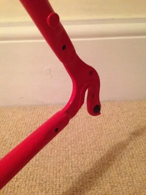

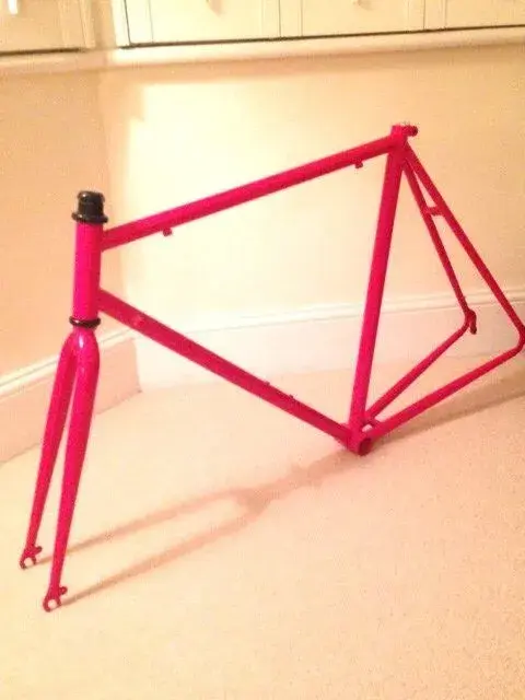

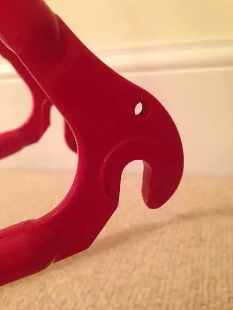

The frame is lugless.
Not sure whether brackets are cast or stamped. Will post a picture.
Braze ons are:
Fork eyelets for mudguards
Gear bosses on downtube
Cable stops on top tube
Cable stop on chain stay
Chain carrier on seat stay.
There is a number imprinted on BB but no luck googling it.
YF02I14511
Headset is 22.2 diameter(it says it on headset)
Seat tube is about 26mm (measuring)
Thanks for help. Not after a full history of frame just trying to see whether it's worth building it up...
Weight is 7lbs for frame and forks (based on my weight with and without it in my hands)
Maybe it is some nicely painted plumbers pipes!
Photos attached below.
Thanks
Will

Chain hanger on the seat stay....I missed that off my list! Only a little detail and not everyone even bothers to use it, but it's a sign that the builder/designer has paid a bit of care and attention.
Straight-bladed fork, if the original, could point to a mid-late 90s frame when such things were pretty fashionable (possibly in the wake of Colnago using them?). Combined with eyes for guards, maybe a lower-end Peugeot or perhaps a Dawes or Raleigh from the time after both firms had farmed out framebuilding elsewhere (YF.... doesn't suggest a Nottingham frame number if it is a Raleigh)? The rear dropouts look decent enough, by the way. Peculiar seatpost diameter may also point to a Peugeot, some of their 90s steel frames - especially ones with the little-known Reynolds 553 cromoly tubing - were very obscure indeed in that regard.
David
Looks like it's in really good condition and should build up into a nice little rider, regardless of the tubeset used.
Remember it is impossible to tell the difference between different tubesets, it's all down to the skill of the framebuilder.
