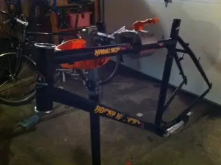

Picked up a Rocky Mountain Hammer Race last night for $20. It measures 19.5 which according to bikepedia was the large size frame. paint seems in pretty good condition, but it looks like it has a stripped crank arm on it. Oh, well. I've removed a few of those in the past. Just hope the bb isn't seized.
Yup, I'll get some up ASAP. Not sure of the year - my best guess so far is that its a 97. Black paint with yellow text with red outline for decals. Decals are in terrible condition. I may start a new thread in the bikes forum for the build. Only downside is I need a new seatpost - it takes a 26.8 which I don't have in my parts box.
Re: How much seat post exposure is too much (now with RM pic

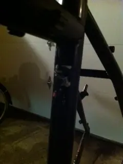

Junky cell phone photos are the best I have now. I managed to remove the stripped crank arm and have the plastic cup out of the bb. I tried to get the drive side out, but even with a breaker bar I was not successful. I've soaked the drive side in penetrating oil to see if that helps unstick it.
