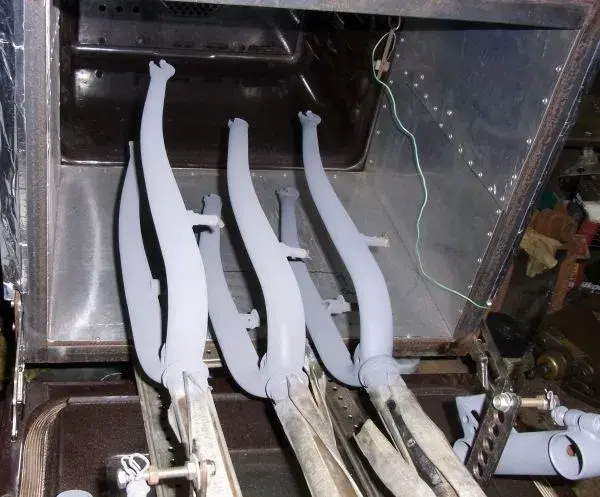

Some Marin forks epoxy POWDER primed. But they will be sprayed.
As to how long powder lasts, well the factory have been powder coating Harley tanks and guards since 1999.
