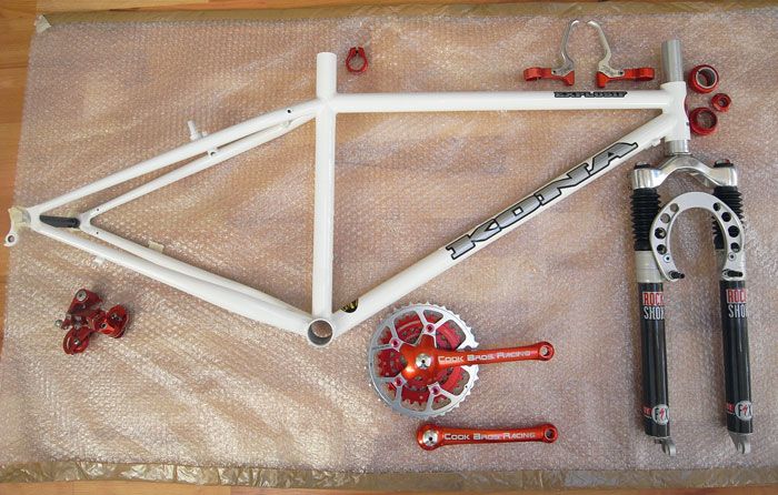

another white kona from argos here - got this back about 2 weeks ago. think it was about 160 in total, including couriers and decals... expensive, yes, but the finish is beautiful and they were great to deal with.
we also rang bob jackson as they were cheaper but the waiting list was huge apparently.

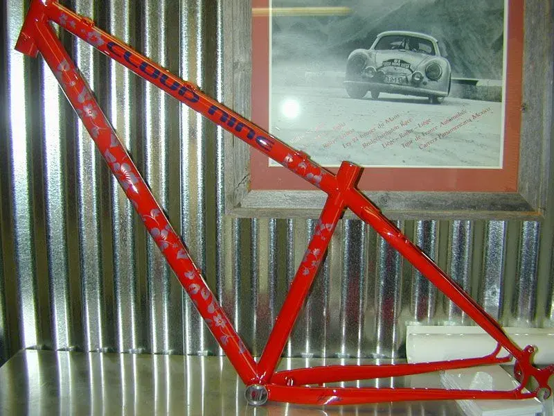

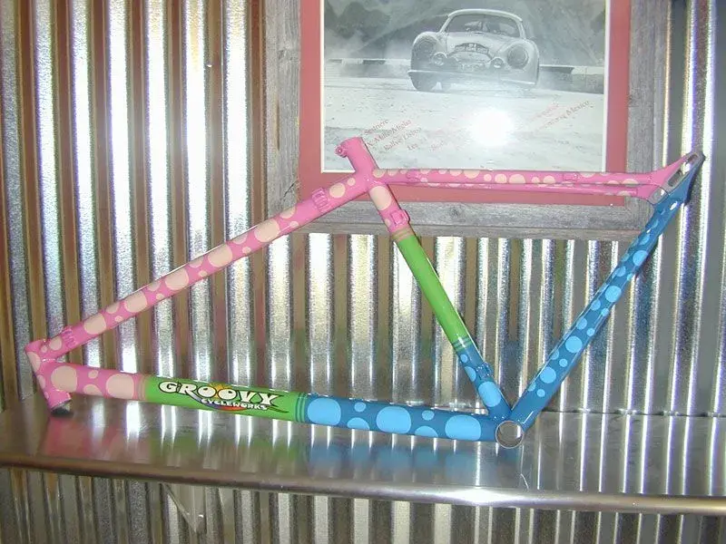

But on the other hand go to the US and you can see some proper powdercoating, such as this frame of Rody's and the Cloud 9, both painted by Spectrum. It's pretty clever work that though, and I doubt if it's cheap!
