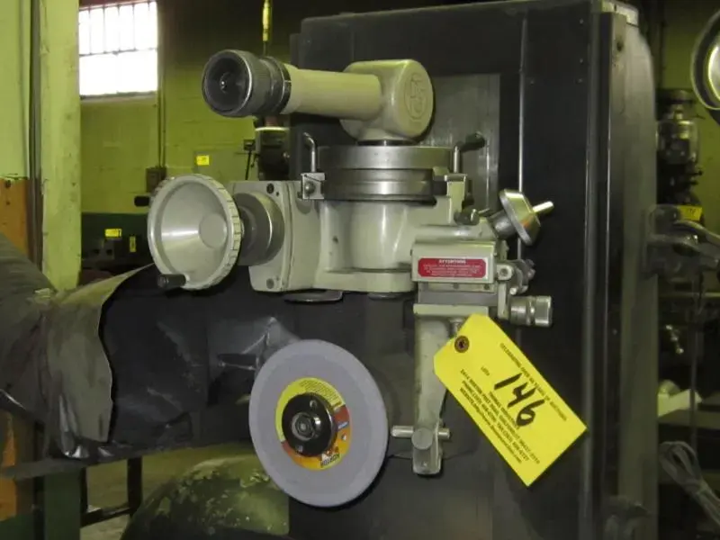

integerspin":1d6t8z8v said:
How did you regrind the race?
I used a surface grinder fitted with an "Optidress" to dress the correct radius onto the wheel and ran the cone (locked onto the axle) in a "Grindall". An internet photo of each is below for reference.
As nobody seems to be 100% sure I'll chop a cone in half and see if our quality guy can check the hardness across it.
I suppose the proof is in the pudding so I've ground a really rough pair on my friends bike and rebuilt it with new bearings as a test.
paddy311":1d6t8z8v said:
DON'T come crying to me when your wheels lock up when the cones turn to cheese though
Well you didn't think I'm actually going to try this on my own wheel first :P .

Far more impressive than what I was thinking. I had someone suggest I use my punch grinder on my surface grinder when I asked for ideas about something like this, I guess that's a punch grinder?
Any chance you could surface grind some shims for me?
I have had the engine apart for several years, it probably won't get put back together till I get a surface grinder, but I can't see enough floor in the garage for one!
I scored some new M760 cones and used them in my M900 hubs, work great.
I think the M760 cones might fit other things, they were Shimano cones and about 2 quid a piece. Those Weldtite things linked to don't look like they have any seals, or do I need stronger glasses;-)
If you chop a cone in half and polish it you should be able to see the case. If I remember I will chop one on half tomorrow.
Re: How do you replace cones when theyre pitted and done for
I suppose you could call the "Grindall" a punch grinder, I work with press tools and that's exactly what we use it for.
I'll pm you a bit later about the shims.
