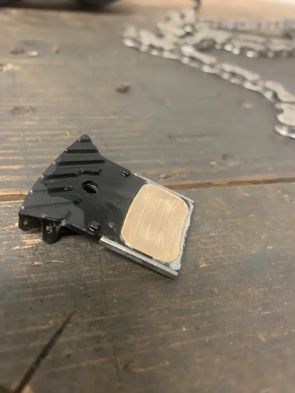

Early this year I ran completely worn pads for a couple of weeks as I couldn’t get spares for ages. I didn’t die.
