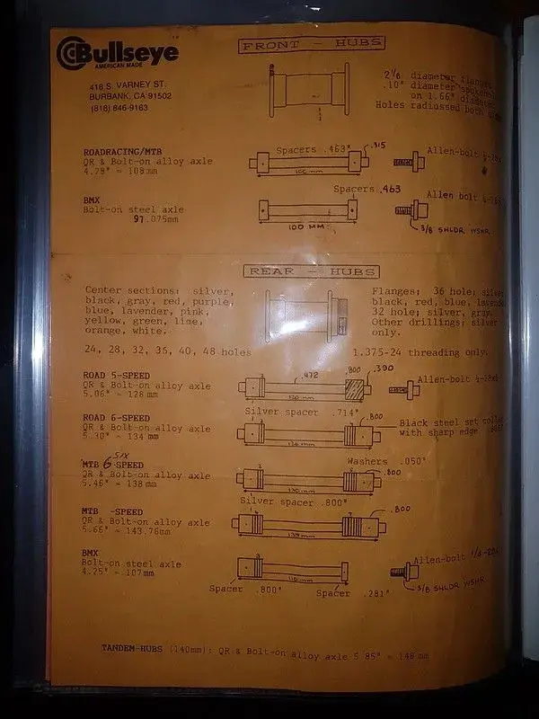

You'll need a new axle and a few more spacers...I have the original instructions , will post them up( think I have posted them up before) @danson67 is machining me some, so you could contact him

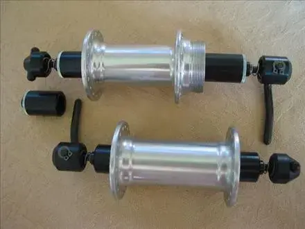

Maybe you are thinking of the American Classic/Kingsbery hubs? There you only had a "stub" axle and different sized spacers for 126, 130 and 135mm, which slide over the axle stub on the non drive side.
Pic from Velobase:

I replaced the axle on mine, not sure how adding spacers would help as it the axle you need to extend so it’ll sit in the dropouts.
If danson67 is machining some for Yakboy, having him make you one is probably your best bet as genuine 143.76mm axles are hard to come by.
