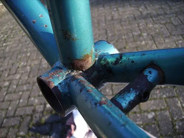

How bad is too bad when it comes to rust on a frame......??

Thanks for the help chaps. Probably have had frames at least this bad before, and not worried about it, but this one really is something I want to try and save....
not sure what the active ingredient in Kurust is but its the same principle, its the Phosphoric Acid in a well known fizzy beverage that means its good for treating rust as well.

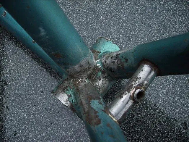

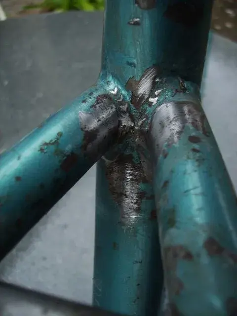

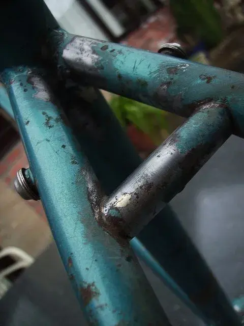

Right chaps, very VERY little effort this afternoon got me to this stage, thinking with some more work and careful application of primer/paint, I don't have a lot to worry about here....?
Sorry for poor lighting on pics, left it a bit late and it was getting dark! ('Before' pics added at end for comparison....)

Thanks chaps, will try and get it finished and painted up soon, while the heating is on full blast to get it properly dry. May see what I think of it with just the primer on, proper rat look!!
Pics when there's any progress...
