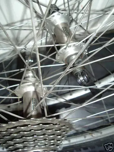

I have seven speed hope titanium hubs, can't find any service info, diagrams or the like. Anyone know where i can attain such ancient scripts?

You'll see some Ti-Glide and Front hub pics in the Archive area.
The is a freehub service guide (in catalouge scan area) which I think should be the same for yours unless it's screw on.
