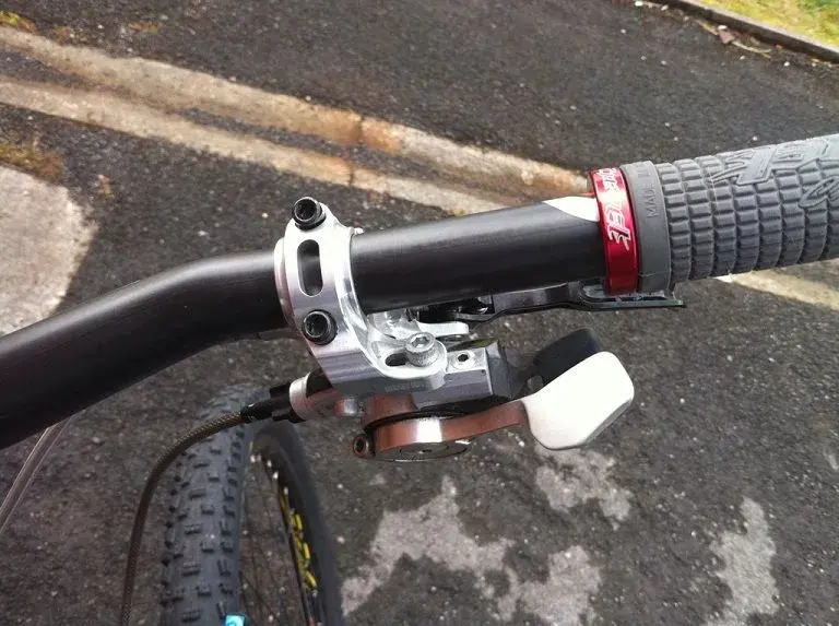

Hope Tech X2
I too don't like clutter and so may opt for them in the future if I find the fixed position isn't vastly different to my current setup. Thanks for the additional info.
I've got the matchmaker too.Hope tech X2's with sram X.9.Without its a bloody nightmare,really difficult to find a position.
