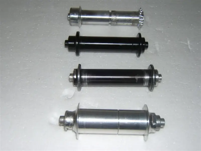

Can any member tell me what Hope front hub this QR adaptor is for. It unscrews at one end by using 2 x 5mm allan keys.

Could be for any of the Hope hubs which can be adapted to 20mm, Big un, Bulb, Hope pro series etc. I've got a few of them and they're all slightly different widths, which is infuriating trying to find the right one when I want to put a 20mm thru-axle wheel in my truing stand.
Its for a bulb
Is the spacer on the other side(the flange bit) is the same length ie identical on both sides, then its a first generation bulb(5 bolt) QR adaptor
Should one side extend out a bit then its for the 2nd generation bulb(6 bolt)
Runs off to retrieve pic :)
Pics from top:
1. BULB 2nd and a bit or somewhere between the 5 and 6 bolt.
Its different in that the flanges interface with the bearings at an angle. Ive no idea of why its different.
2. Standard modern 6 bolt bulb
3. 1st generation 5 bolt bolt bulb
4. Big UN 25mm qr axle
Bulb 5 bolt hubs and 6 bolt hub QR axles arent interchangeable. Only the correct one fits the other doesnt.
