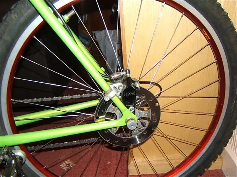

Hope No2 calliper ??,news to me

What the hell does the no2 calliper fit :shock:
Ive heard of callipers 1, 3, 4, 5, 6, 7, 9, 9:74, & 11,but never a 2

I had one of these in black on the clockwork but im sure it didnt have a No2 on it :?
Nor did it have the lettering filled out in red nor those cutaway sides on the calliper
Limited edition perhaps :? Or more likely somebody's been at it with a red marker :lol:
They look minty , i only hope they are the same internally and dont need a major service.

No.this calliper incorporates an adaptor
My interest is in that hope dont have a calliper No2 listed anywhere,i jusy wondered where it came from,might be from a different country.
I'll ask the seller where he got the bike.
Its the type with where one side of the calliper is extended and mounts to the side of the dropout,it creates a false dropout.
You need a special hope axle to fit it.
As the calliper mounts to the inside of the dropout it makes that spacing about 135[i think] instead of 150mm,therefore the smaller wheel
I think you also need to redish the wheel to take account of the shorter axle :?

i think you need a torque arm as well, that bolts to the canti mount, to stop the calliper rotating.
Mostly you do
when i had a hope no2 fitted to my clockwork,the mechanic didnt have access to one so he made something to fit ,namely a small bit of alloy jubilee clipped onto the seat stay :lol:
In my opinion,its far neater and worked for near 8yrs through everything,without any problems
Fitted and forgotted :D
