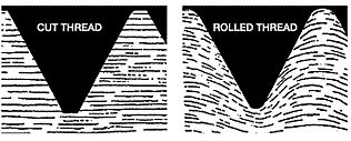

Mass produced hubs (such as Shimano) tend to be made using a forging process, whereas Hope and other boutique hubs are usually made by machining a solid piece of aluminium billet. This is an important difference. The forging process tends to produce stronger hub flanges because it causes the material's microstructure to flow into the shape of the hub and its flanges, and the deformation during the forging process can increase strength. Furthermore, forging causes compressive stresses in the surface layers of the hub flanges, which helps to resist fatigue crack initiation and growth.
For the same reasons, rolled threads tend to be stronger than cut threads (machined threads). Rolling threads is essentially a forging process that strengthens the material by causing the microstructure to flow into the shape of the threads. The deformation strengthens the material, and the compressive stresses created in the surface layers help to resist fatigue crack initiation and growth. The increase in strength and compressive stress is particularly important at the root (trough of the thread), which is where cracks are most likely to be initiated.
Left Image - Rolled Thread
Right Image - Cut Thread
