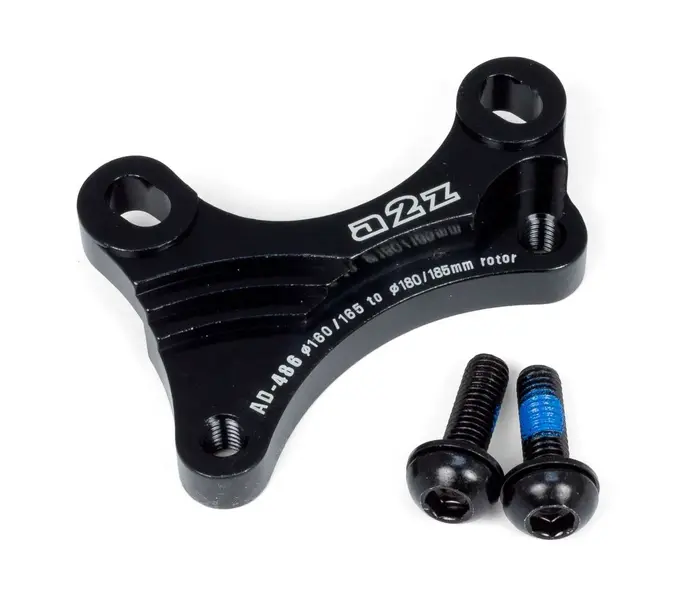

Some potential alternatives, available in +20 & +40mm. Not hopeful.

I have a similar issue with my Pace F8 frame, the rear disc mount is a bit square on the top hole.
In this case it seems to take a mono mini caliper OK but I tried to fit an M4 and had the same issue as you. I tried the adaptors too, Hope +20 and an A2Z +20, and neither would fit. Seems odd but also not that surprising really.
