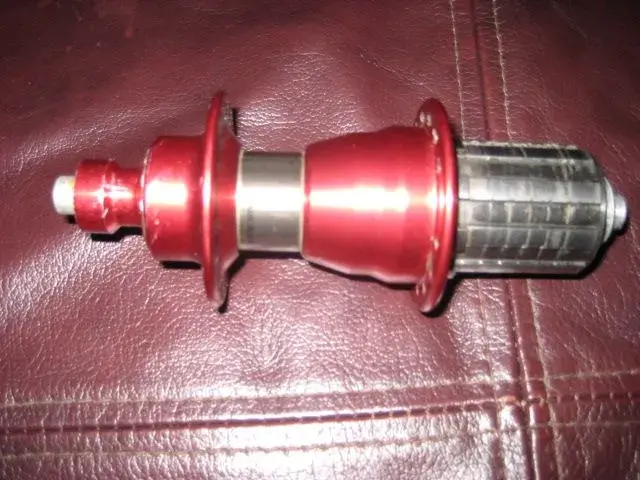

what hub is this ?
i have just bought this hub and it needs new bearings. can anyone tell me which hope model it is ?
Ti-Glide, later model (notice the slight wave in the drive side flange, hence I call it the wavy version)
Hope shoudl have the diagram now, there are also quite a few threads on bearing changes.
Same, other than the shell as Ti-Glide/Mono/XC
4x 6001 bearings in there (get 60012RS )
ebay sell them or CRC etc
