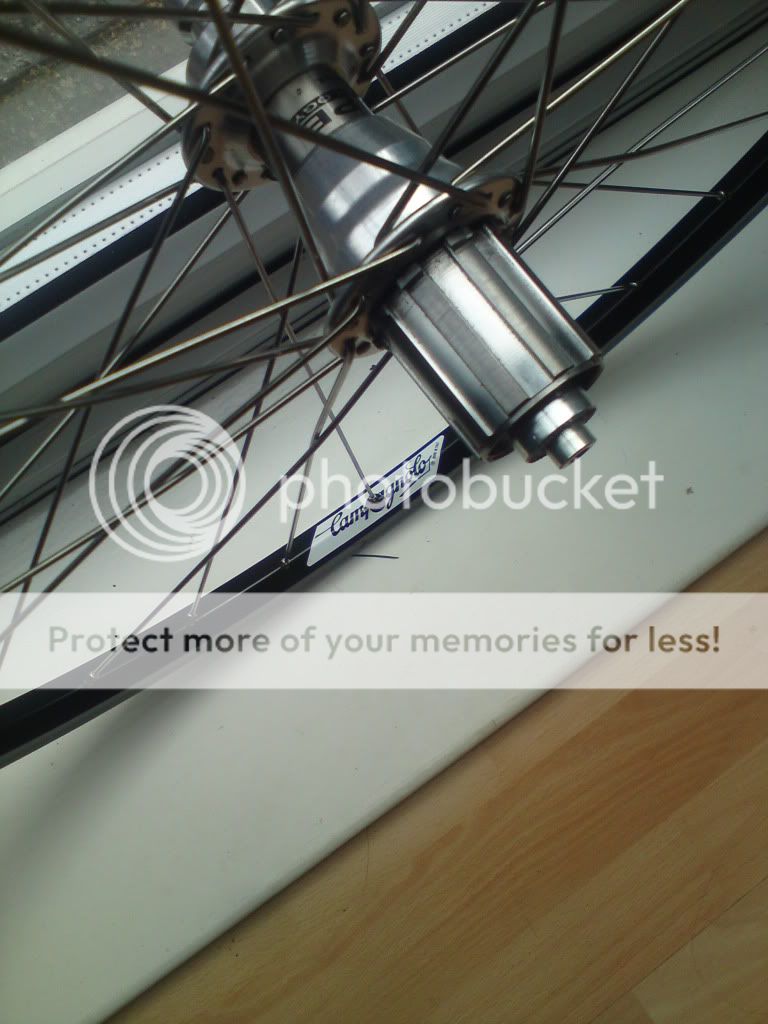

Thanks for the replies guys, fluffy, if you don't mind a couple of pic's would be great. Here's one of the hub I've just had built, if you can identify the year that would be great.
Thanks
It's the original decals but not the original right shell.
My original Ti-glide was bought in 94 and the Fatso a year later - both have the same decals. So my educated guess is that it's 96. They were discontinued around 98/9.
I just serviced a hub I bought on here which is identical to this one and it's fine, despite the bearings being totally worn out.
