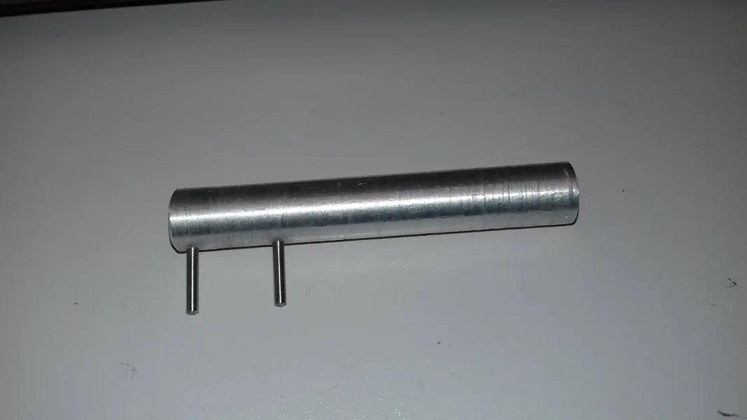

What tool is recommended for trying to unscrew the pistons? I have a few stubborn and seized pistons I'm trying to free-up at the moment.
I have a Park Tool adjustable pin spanner, but it's too bulky to get any purchase at holes opposite one another.
Feels to me like a tool that can engage all/multiple holes at once, would work better - like a Royce BB tool, but I haven't seen such a thing for pistons.
I've been using rolston cheapo circlip pliers, with the smaller pins snapped off. The bent or side pliers is the one. Its all about applying downward pressure, at least to begin with as the mount is copper/copper coated so theres usually a bit of stiction.
I find the side shape allows me to press down with the heel of the hand and turn using both. Once its moving you can let off a bit of pressure, but they do still have a tendency to slip, so be aware and if you feel the pliers start to slip, take it off and reposition.

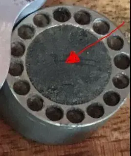

What is the material on the face of the piston? mines gone a bit lumpy since soaking. I was wondering if best to remove it or try and flatten it back down?
