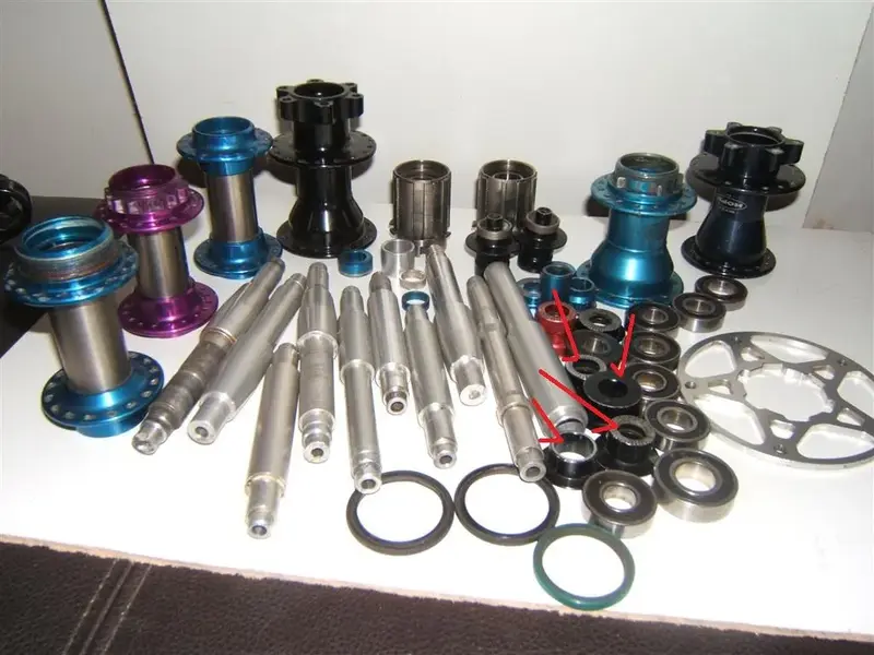

Its down to the inner dimensions of the bearing fitted
For example im sure you can fit a thicker bulb axle into a ti glide . The bearings for the bulb and ti appear to share the same outside diameter so you use the bulb bearings. :?
The inside diameter of the Pro2 bearing fits the 9mm qr end spacers or 20mm circlip in spacers. What is its outside measurement :? Or could you find a bearing with the bulbs outside diameter but with the pro 2 inner size
See what i mean ?
I would think it best to check spacer thicknesses also as hope seem to have a bloody huge range
In the pic the bulb bolt through spacers are 2 of the ones with the red arrows on them. Which 2 i cannot remember :lol:
The one pointed out at the bottom on the left cos that is what my 20mm ones look like in my Bulb.
I also believe that the first gen Bulb like you have uses a different axle to the later six bolt ones.
See what i mean ?
