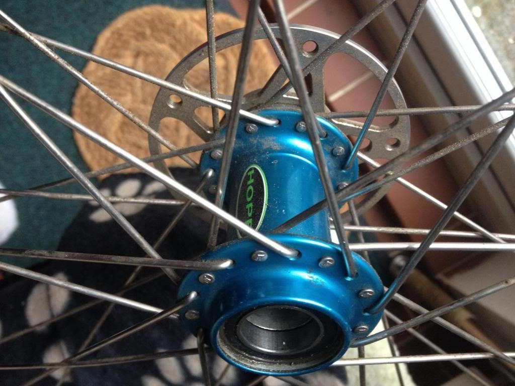

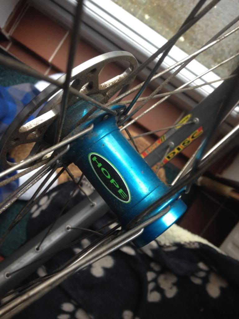

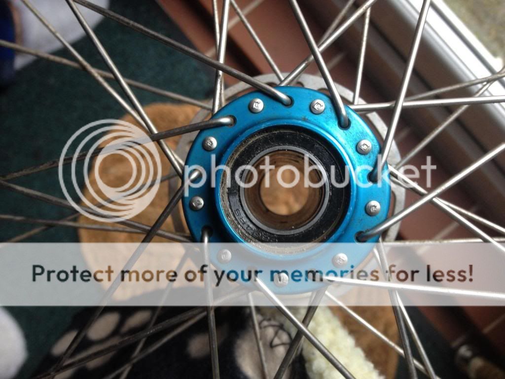

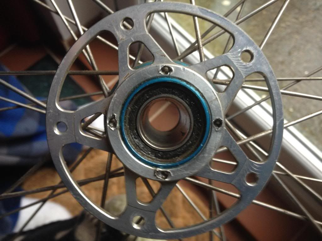

I acquired this yesterday off a mate of mine (did a swap) I'd like to use it but it seems to have no guts? Bearings are there and appear to be smooth but is there any way I can get a quick release to run through it?
Or is this it to run with an old style thru axle?
I am also confused as to what model it is, hope bulb?
if i'm right in thinking you seem to be missing the end caps, and that's it-hope still seem to stock most parts so send them an email - they also will help you id it 99% of the time
^^^^ what he says.
you'd be looking for 9 mm q/r adapters, similar to these:
other axle types are avialable, for example:
http://www.tweekscycles.com/Product.do? ... tAodC38AgA
Similar but not the same
I have a set from a 150mm bulb so dont know if there are any real differences in thickness :?
