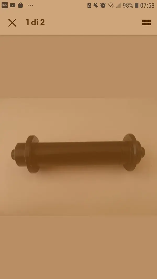

I've been trying to source one of these 20 mm through axle to 9 x 100 mm QR axle adapters for ages. I recently got one of the older Bulb hubs with the castellated rotor mount. The axle from this hub does fit the slightly younger one, but it is a touch too long for the 6 bolt hub shell. I would swap entire bikes for this part at this stage! Any help much appreciated.
Not sure if this helps, but I have a pair of black, 6 bolt bulbs not doing anything right now. They are both qr. I also have a few hope spares. Do you have a pic of what you are looking for? Can't promise but I can check to see if I have what you need.
Thanks for tour reply. It looks like this and might be found inside a Bulb 6 bolt front hub.

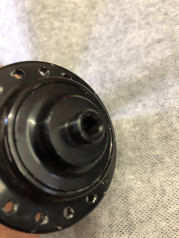

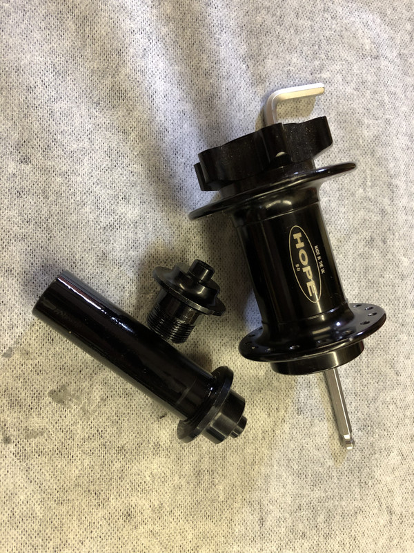

the axle is screwed together, you put an Allen key in each end of the qr hole (if you look closely it should be a hexagon not round).
Op, I have one which I would be happy to swap for the correct 20mm end caps if that helps?

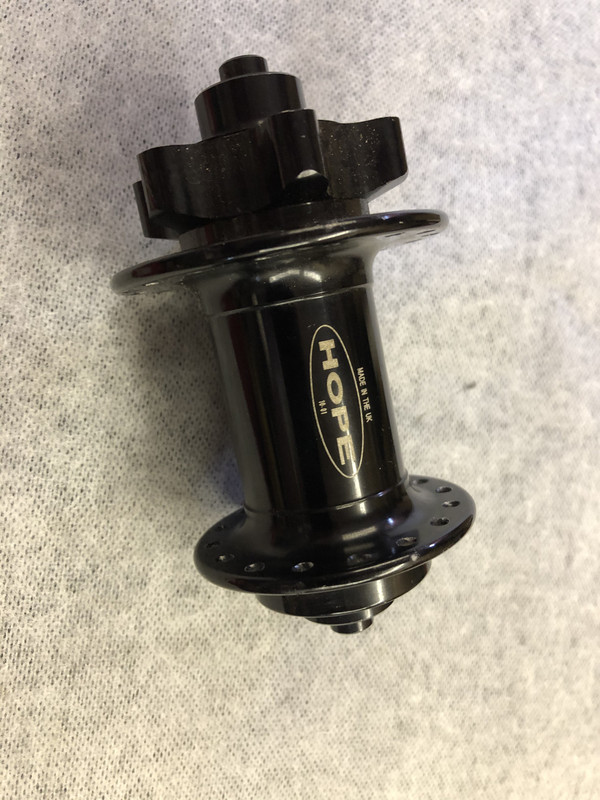

So popped out to the garage and took some pics.
Qr bulb hub
Allen key in end (sorry it’s a bit fuzzy)
You will need 2 Allen keys
Disassembled
So like I said happy to swap for the correct (19mm & 13.5mm) bulb 6 bolt 20mm end caps. Unfortunately they are proving tricky to find aswell and if I let you have my qr the hub is unusable without one or the other.
