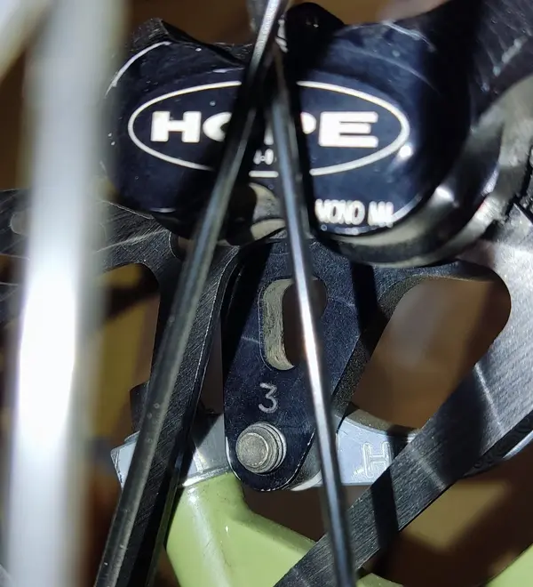

Ok, what I've ended up with are 203mm discs, I found them in a box. The rear fits ok, although it looks like there may be room for a 205mm? The front however needed a washer under the adaptor to clear the 203, so maybe a 200mm would be correct?
The bike, on one bootzipper, came with 180 front with a 20 mm spacer, so 160 posts? The rear came as a 160mm direct on the posts.
It doesn't make any sense,but they look great and work well.

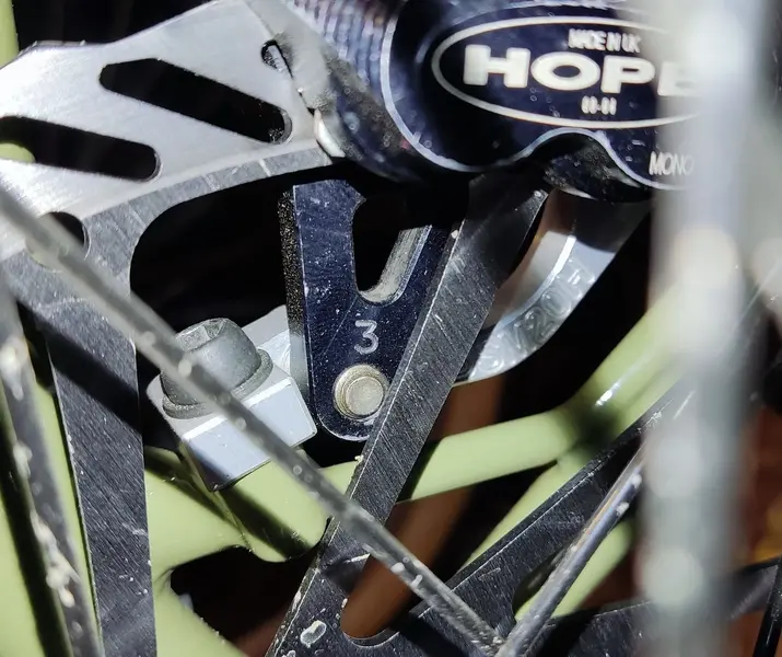

The Caliper numbers should be on the back side of the lower mounting bolt, they are the 00 size however I wonder if you have a 3 (IS) and a 6 (Boxxer Fit) which is a different 51mm mounting and would fit an IS mount but would move the Caliper out from the disk and not contact it properly
The reason I say this is visually the 2 Calipers are not identical which makes me think it’s a 3 & 6 as opposed to a 3 & 5 (both IS just longer / shorter lower mounts) or a 3 &8 (again one longer / one shorter mount)

I hadn't even noticed that they weren't the same? One of them is a number 3, I'll have a look and see what the other one is.
Maybe then if I swap them over, front to rear, they might make sense?
Ok so the mismatched numbers is out, yes suspect they are different years / batches which means the issue is in the post mount, sometimes a shim under that will lift the Caliper to where it’s needed… I had to shim my 200 rear out as it hit with just the adaptor and brake fitted
You can see in the second picture that I've fitted a washer under the adaptor. It works fine, but if I was being picky, I'd say it only needs it under one end, as the rotor is closer to one end of the caliper than the other.
I'll have a proper investigation in the winter during a service, for the moment I'm just riding it to work and enjoying it.

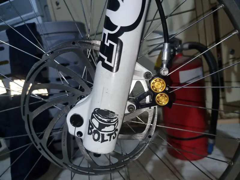

I bought the same brakes for my build back fits great but fitting to fox 40 forks and I think they must be both rears as it sits to hi even with a 220mm rotor.
On the hunt for a front caliper now.
