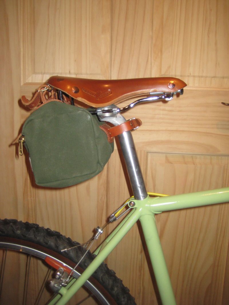

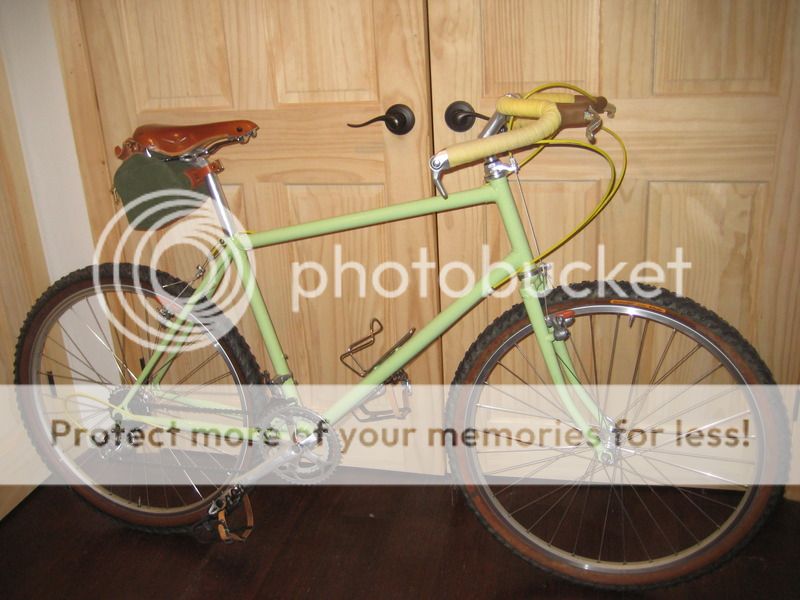

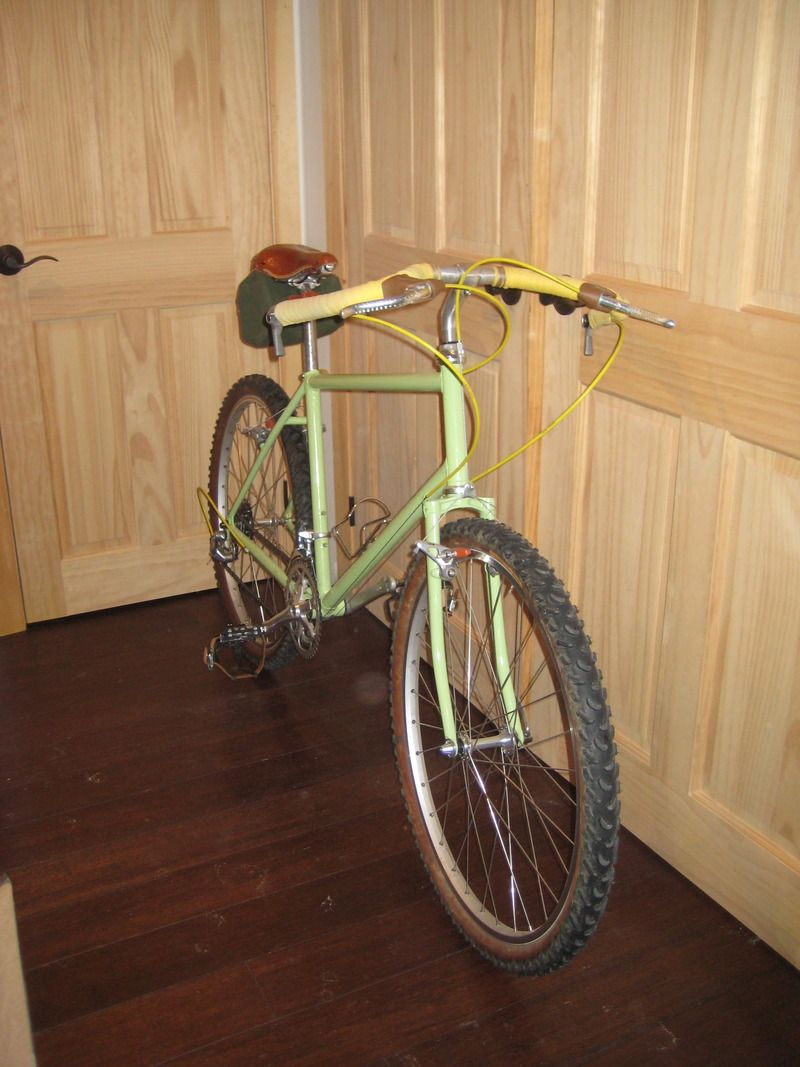

The frames a lightweight at 1.8 kg using Nivacrom 7/5/7 and Nova lugs, the fork is built with an old Tange crown. I sprayed it with 2-part auto epoxy. My goal was to build a light, fast mountain bike with high handlebars - something different.
Headset: Neco
Stem: Nitto dirt drop
Handlebar: Nitto moustache
Brakes:730s
Brake Levers: Dia Compe
Shifters: Shimano barcons
Front Derailleur: XTR
Rear Derailleur: XTR
Cranks: Specialized
Pedals: Suntour XC Pro
Clips: Specialized large with Cat Eye Snake Straps
Rims: Alex
Hubs:XT front, Sansin Microlite rear
Tyres: Ritchey WCS 1.5"
Saddle: Brooks Swallow
Seatpost: Kalloy Ritchey
Weight: 11.3 kg
