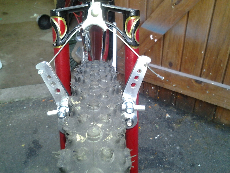

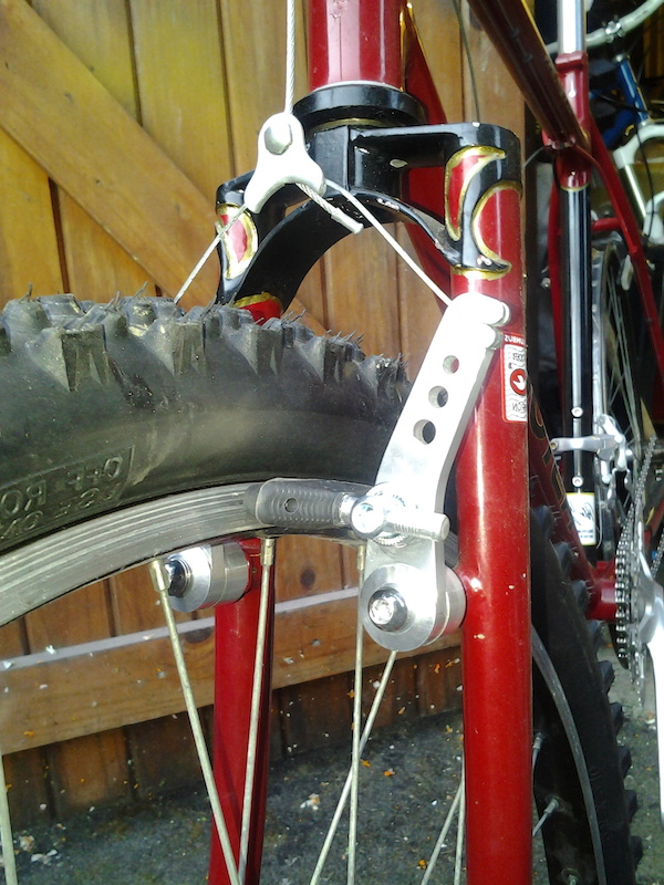

Home made CNC bike parts ~ old school style
Nice one Pete, looks like they will do the job!
Ive got to make a few more brakesets for my ever expanding bike collection. My latest endeavours can be seen in my blog linked below.
There is some really nice home made stuff on the MTBR VRC forum.

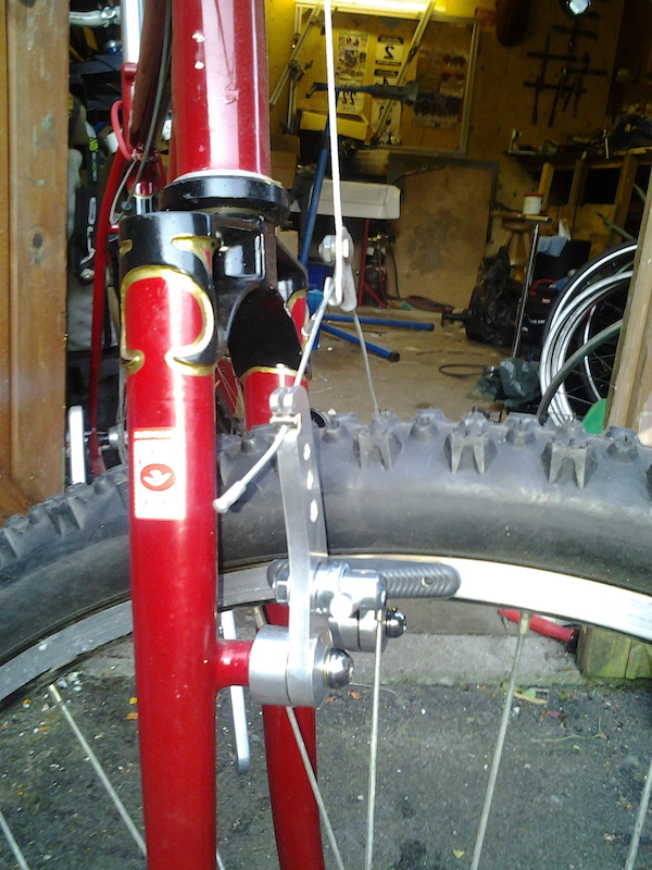

thanks i will pop some pics up if i get them working well.
Do you do small comisions if i sent you the right file types (igs file?)
Cheers
Pete
I have a really long list of work to do for myself and some mods to my machine to do, so major commissions are out really! :) The disk adapter linked above actually looks quite complex to me and would take me many hours and mistakes to get right.
Biglev, im sure you will get them working somehow, if you need anything specific let me know, but I am not an expert, this is just a hobby and a learning process for myself.
found some new springs,pads and mounting kit. all fitted and work a treat very happy.
