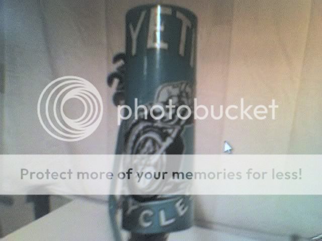

In addition, I just noticed something.
The headtube decal is custom.
The real deal:
The auction photo:
It appears its some sort of cut and paste hybrid between 1st gen Yetiman and the Tomac headtube decal.
Didn't Tomac's have 1" headtubes? Although the seller says its 1 1/8" which is surely 1/8" out either way?
