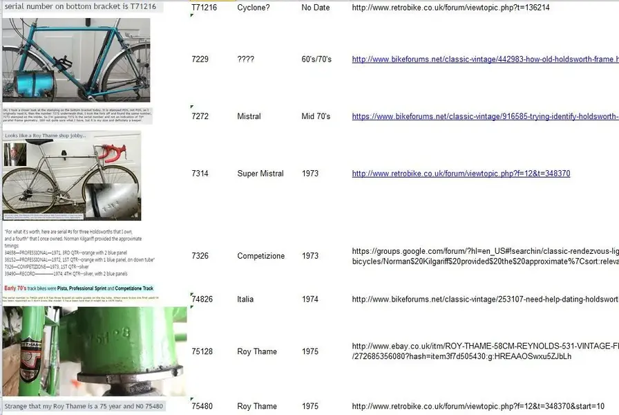

7314 'Looks' to be a Super Mistral Fastback, 75128 is a Roy Thame bike same as the other 75 number 75480. I have included these here as they look like shop numbers and I have seen latter RT bikes with totally different numbers. There is a comment on the history site, I think, saying late shop Holdsworths carried RT badges. I think this is evidence to that effect.
With the exception of 74826 all other 71 to 73 numbers are only 4 digits long. Initially I had these in with the group of 4D 70's numbers which inc. a lot of custom built frames for other companies. These were remove as the original group seemed to have a brake between 4000+ and 7000+ leading me to believe that the 7000+ numbers were 70's shop frames.
You should have access to my cloud site to be able to take a copy of the Excel file with all these frames shown. There are pictures and links to most. I would welcome your views particularly on the 70's 4D numbers and the latter shop frames.

Looking at present "Shop" numbers there are a few that are perhaps less accurate than others.
674706 - This Pro frame on Classic Lightweights is reported to be Bob Addy's bike. Number is an unusual 6 digit number, however it is not a reliable number. When one looks at link to Velobase, this frame's number is stated to be 674108. Corresponding with new owner, he says the numbers are significantly obscured with paint. IF number is indeed 674106/8 I would speculate this is 106/8th shop frame and built by Collard in April, 1967. Whatever, not a helpful data point.
T71216 - This bike is presented with 2 posts on Retrobike back in 2010, The frame apparently has track (thus "T" ?) dropouts with derailleur braze ons but no identifying decal or badge details to suggest it is a Holdsworth and no pics. Owner simply wonders if it is Typhoon model Holdsworth. This is not a helpful data point.
7314 On retrobike a year ago as Super Mistral. In '73 shop did not build factory models. I'd identify this frame as Shop Model, the Chronometro (not Ultralite).
74825 This is called a '73 shop model Competizone, but reference to Classic Rendezvous link labels it as 7326 which would indeed make it 1973. Error? Not a good data point.
74826 A single post on Bike Forums way back in 2005. "it it has three brazed on cable guides on the top tube. When were braze ons first used? It has been repainted so I don't know the model. I have been told that it might be a 1975 Italia". No Pics. If indeed an Italia number would suggest it is from 1974. However number is unusually high and with little corroborating evidence is not a helpful data point.
75480 Roy Thame. On Retrobike in same thread as 7314. This number is reasonable to suspect a Shop build in 1975. However it is a high number as well. I have collected at least 2 other Roy Thames (75226 and 75395) that fall in this group. It would appear that Shop indeed converted to Roy Thame brand in 1975. With high numbers perhaps "75xxx" numbered Roy Thames were carried on into at least 1976 before converting as Dave points out to a different type of numbering system. (similar to 69xxx''s) Again speculation.
