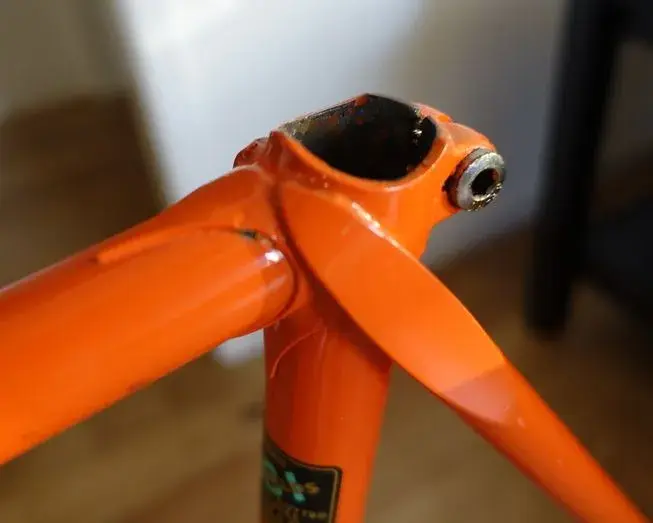

Yes color was another thing to look at, I was going through the list on Kilgariff site for the shop pro. Rivets and color was one thing I was wondering how to confirm, will have a look at this. Think the other things on the list are all either correct or there is evidence of the use of alternatives, ie stays and crown. I have just re checked the frame angles and it is easier to assess these as 73 deg parallel than trying to convince my self there were 73/74 as the factory frames. Bit difficult to get good reading, but did it with spirit level and also angle measuring app. You do end up trying to convince yourself you are getting what you are looking for.
one other item that is missing from the 69 shop Pro spec is the integrated seat stem clamp bolt. the examples I have seen so far have the full wrap over stay, but the one above and mine have the semi and Campag bolts. Maybe these go together?

Anyway the conclusion I am coming to is that the road shop pro's follow the ID points on the history site, but the Pista/track frames don't. I'll keep looking but I only have my 69 frame to go on which seems to have the sloping crown seen on earlier (1966) stock track frame and the close semi WO stays with Campag Bolt. (I think the badge rivets can so easily be changed, who knows what happened here)
The factory road pros again follow the usual recognition points, but Sprint/track may well differ. There is a track frame on the history site from 1975 with full wrap over stay, then we see the one above which could actually be from 1978 with the same close WO/campag bolt combination as my 69 shop frame. At around the same time (~1978) the road pro picked up the wider spaced semi-WO stays that other model had.
I have to say I have very little to go on, may be the semi WO was offered as a option on track frames? Anyway I am satisfied I have a 69 shop frame with a fork crown that had been in use around that time. Not sure why it seems to have a 'later' seat lug/stay combination, but may be this had been around as an option at that time too.

Just to mention that Raleigh/Carlton Professional track frames seem to have had the same top-eye treatment as these Holdsworths, through the first half of the seventies, before changing to the angled cap with no wraparound.
Yep, for some reason some of the Carlton Pro track frames had the usual "flyer" seat stay arrangement despite not being a Flyer.
