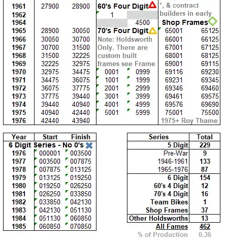

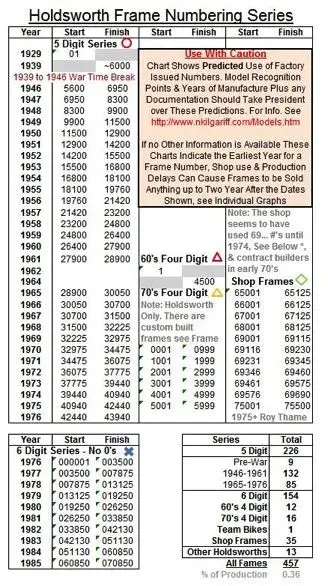

yes I may be adding to the confusion when updating the charts, this has been done recently. The latest thinking Doug is referring to is below. There are so many 69 frames they can't all have been built in that year. As I get more numbers I add them to the Excel file and update graphs and charts periodically. Best to look in the Google Cloud site.

I'd agree #69215 looks like a 1970'ish shop Pro. (Unclear but 69 numbers seem to have spanned years 69 to 73)
