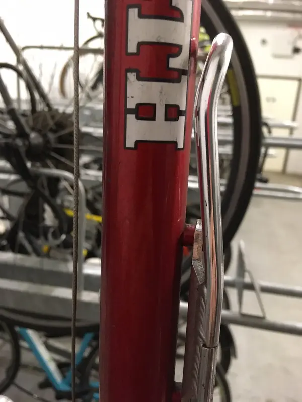

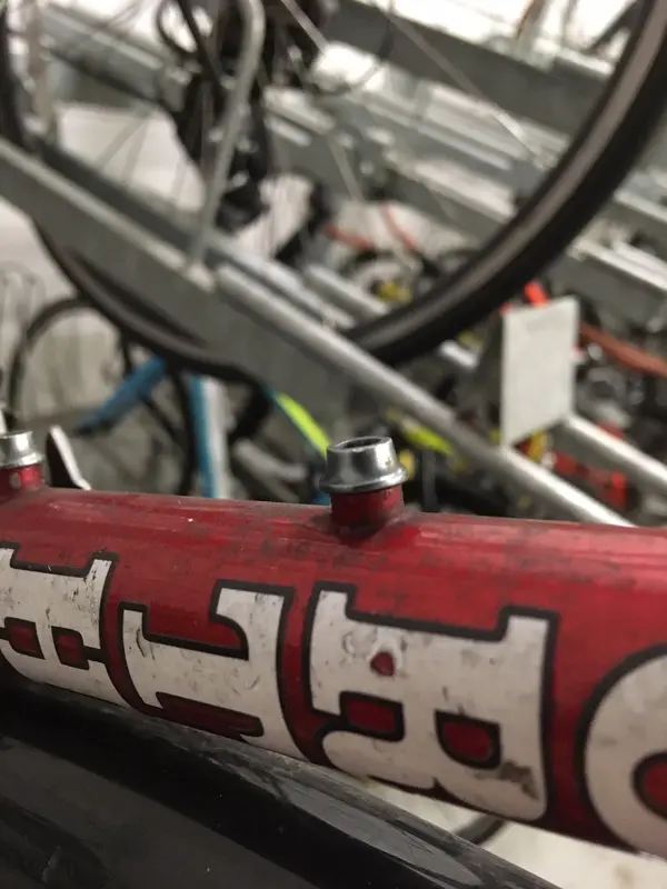

2 sets of bottle bosses support this although perhaps later ad-ons at time of repaint? Are there actually braze-ons?

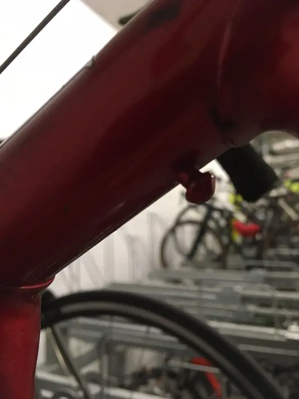

A clip for RD chain-stay cable guide is unusual as even when braze ons were frowned on c.'70 most frames still had a rear cable guide. Original on top of chain stay perhaps removed? Makes me wonder if hole in bottom of BB was originally for a grease nipple? Is it threaded?

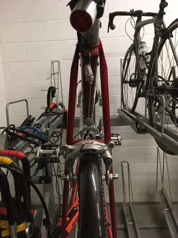

Pics of rear brake bridge will be good.

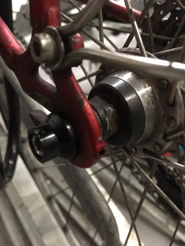

Got some more pics as an update including brake bridge and braze-ons... maybe this will help you... CBguy, Wileyone or dwscrimshaw?
By the way... not trying to suck up to your egos but I am very impressed with all the knowledge here! This is my first time reading into frame building and it has been really interesting... I can see how it could easily turn into a dangerous hobby!
EDIT: Sorry pictures aren't rotated... thought they were :( Also, in reverse order with brake bridge last.

Personally, I find it easier to believe that this is an early '70s frame that has acquired a collection of braze-ons, than that it's a late '70s frame that has acquired anachronisms like full wrapover seat stays and a fully sloping internally lugged fork crown.
IF this is a Holdsworth it is beyond sell off. It does not fall within recognized serial systems or catalogues to 1985.
That pip braze on attached to the head tube is not my era which is the 70's. Is the frame built for allen key brakes bolts but using nutted brakes with the mudguards?
If I were Sidolis I might be inclined to get in touch with Mercian and ask them if it's one of theirs- a 1970 'King of Mercia'?
