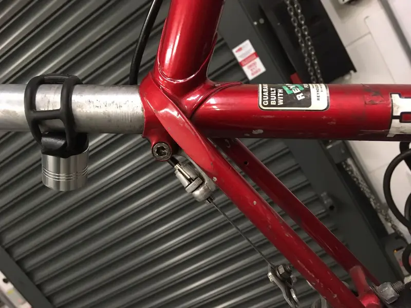

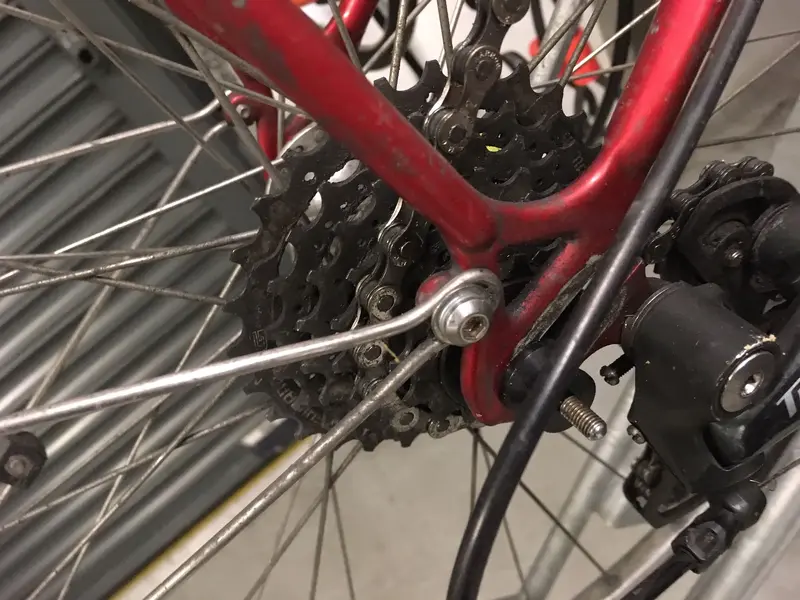

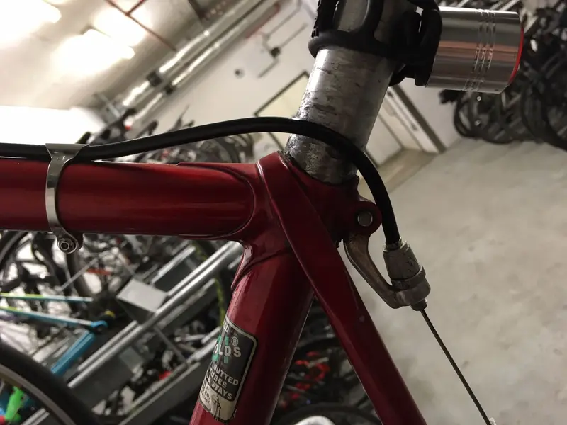

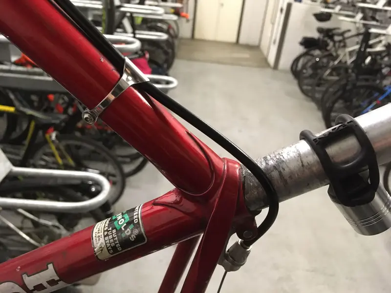

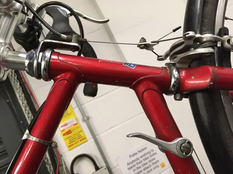

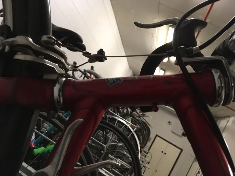

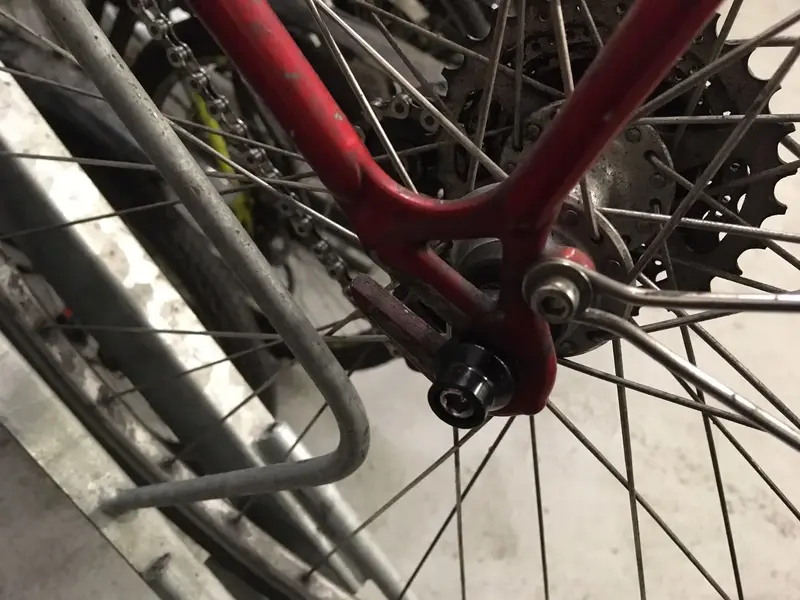

Took a bit longer than planned sorry -- here is the lugwork around different bits...

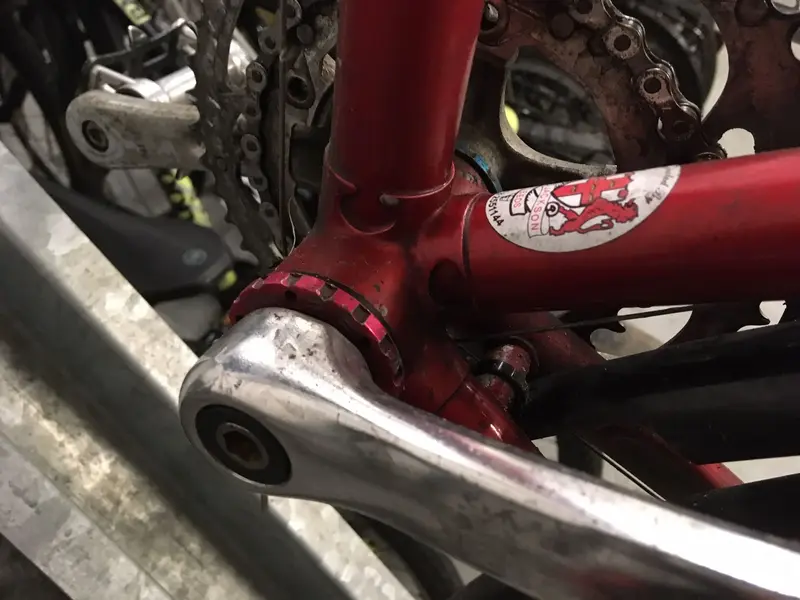

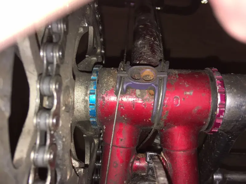

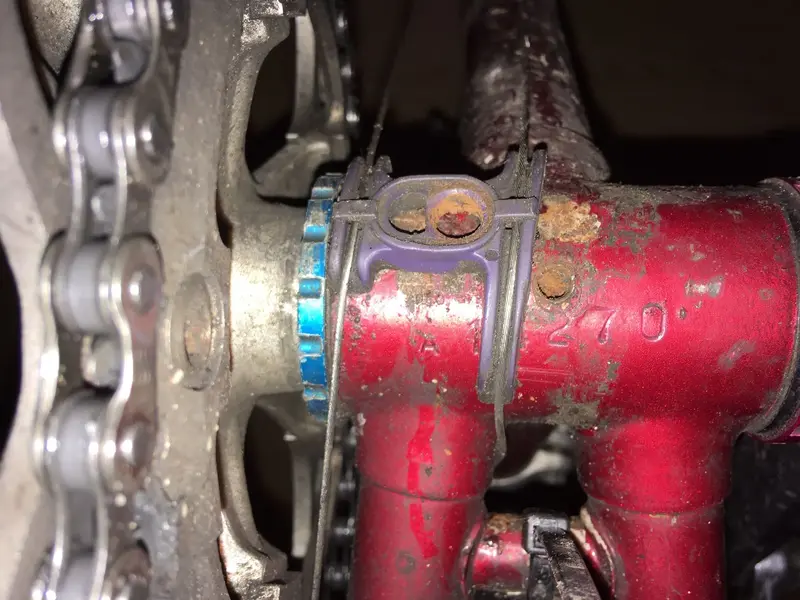

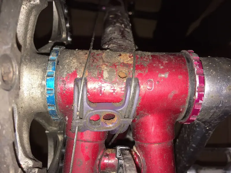

...and here is the serial number. It's under a bottom cable bracket I didn't want to fully remove so a few shots to get the full number (A 14270, A seems to be a little smaller?) by moving the bracket around.
That number is in the wrong position on the BB shell to be a Holdsworthy number. That's more like Bob Jackson position, except their numbers were usually the other way up.
Some marques (not Bob Jackson) used either the first two or last two digits of a frame number for the year. In that case your frame would be the hundred and forty second frame built in 1970. Possible makers who spring to mind- Mercian, or Witcomb. I'm not familiar with their stamping position. A bit of research, or the kindly donation of information from a Mercian or Witcomb owner, might help.
Those cutouts around the tube sockets of the BB shell are quite distinctive and might be a useful identifier.
(posted before visiting the link in your last post)
Hi, the wrapover stay is very Holdsworth, but it was a common feature in the 60's/early 70's, the mudguard eyes point to a club/standard machine, and the suggestion of Witcomb could be good, as the serial number points to it being a 1970 example, worth investigating.

The A at the start is a bit odd. The frame looks too new to be a Holdsworth 5D number and from 1976 would be a 6D number placed higher up on the BB. Wrap over seat stays were gone by then. The BB lug shape is also odd for Holdsworth I think. Can't place this as a Holdsworth, is it possible a 1960's Claud Butler, that where the number sits in their system? Maybe others can comment comment on lug and stay combination.
From looking at CB and Witcomb numbering systems it seems unlikely to be either. Does anyone know if anyone ever did serials with letters at the start? I know very little about this but have never seen one like that in all the stuff I've looked at.
