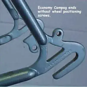

Number is far too high compared with others documented as 81. http://www.nkilgariff.com/ shows a 81 Elan frame number 031692 and highlights Holdsworth decal position for 81/84 and lack of rear spindle adjusting screws for 81.
I am using this as 84 model because of decal position. (not just because the number happens to fit 1984 nicely, honest!)
