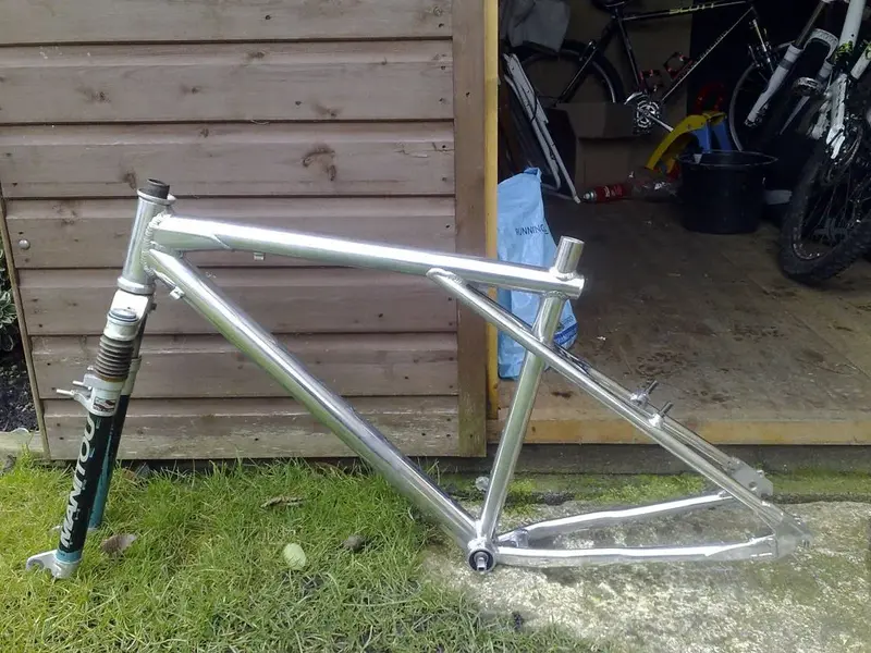

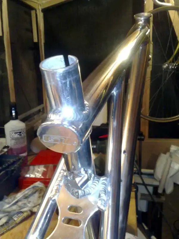

Frame now polished see pic for results wet n dry1500, scotchbrite green with cleaner paste then autosol. finshed with polishing mop no substitute for elbow grease.once degreased then decals
& Megulars polish

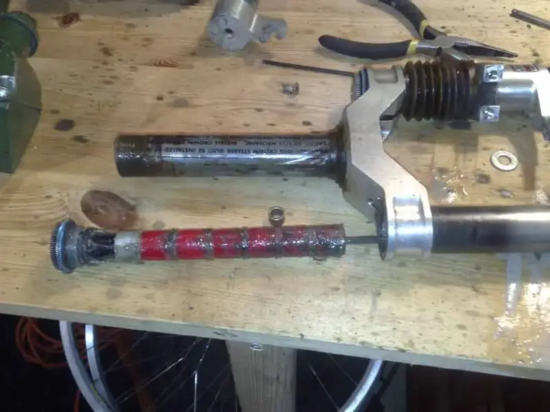

Fine work there, triple traingles are a right pain in the erse to get into.
Lol you`re right there, trying to hold the frame was the biggest pain no tool /bike stand yet on order.

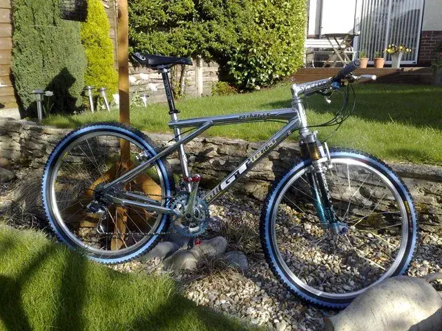

finallly

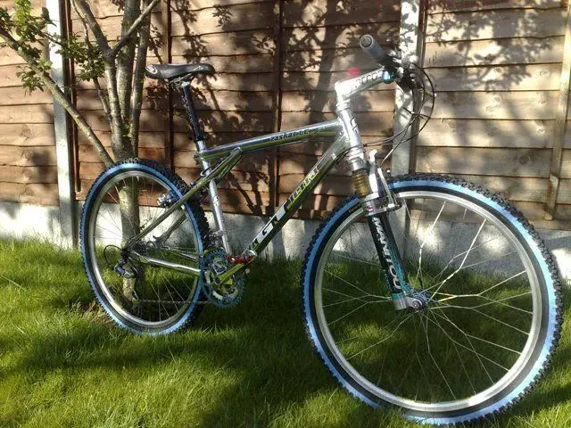

After what seems ages finally ready to take to the road/sorry trail.
DIY kitchen duties from the wife have kept me busy.
Thanks to Gil for the decals L,B,S Cycle Fix for some advice a few bits and help,;suspensionforkparts.com for the elastomers for manitou 3
Not quite there need another onza ho as one arm broke doing up and going to change to amber skin wall tyres when i get to it.
Cheers buddy ,went well today on my commute, trail way and cycle path .
Defo quicker than the full sus rig liking the ride although the stem is mighty long but hey cuts down the wind resistance ( is this the way we used to ride) :o
What next ? going to enjoy it and see how sketchy it feels out in the wilderness :D
