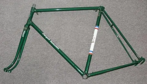

I have just finished restoring a Helyett Speciale to original spec (or as close as I can get) This frame was one of those sold by Helyett (they had an office in Willesden, NW London) around 1960 and I am certain these were made specifically for the UK market as it has a British thread bottom bracket. Frame has to go back to the stove enamellers for clear coats now that I have added the decals and lined the lugs.Then I can build it up.
Looking forward to riding this one. The build quality is OK but not top notch in my opinion, certainly I have other frames that are brazed & fettled better than this one. However, they are not so common and since Anquetil won the TDF 3 times on one of these (or so I understand ?), it is an interesting machine.
Photo is poor quality. I will try to get some better images when I am here in daylight (weekend) and will post them.
