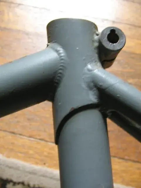

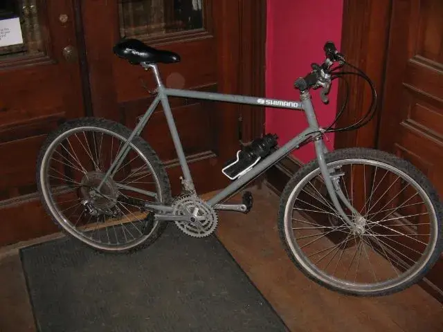

Hello, new here, but I thought I could add to this topic-I just picked up a very early Marin, advertised on ebay as a 1986, serial number A870691932. It uses Tange 'MTB' double butted tubing, tig welded with a lug-like reinforcement atop the seat tube. It was advertised as a 'Joe Murray' model and has a sticker at the base of the seat tube that says 'Designed by Joe Murray, NORBA Champion 1984-1985'. I believe the original color was forest green, and the previous owner really likes Shimano, based on the size of the sticker on the top tube!
It's a neat bike and fits me very well. Anyone ever seen one before?
