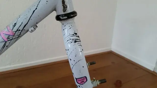

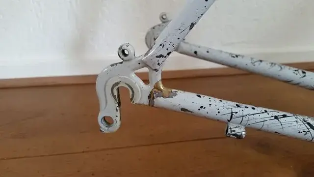

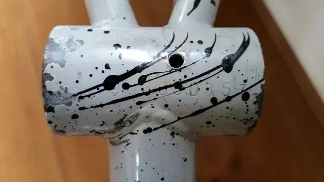

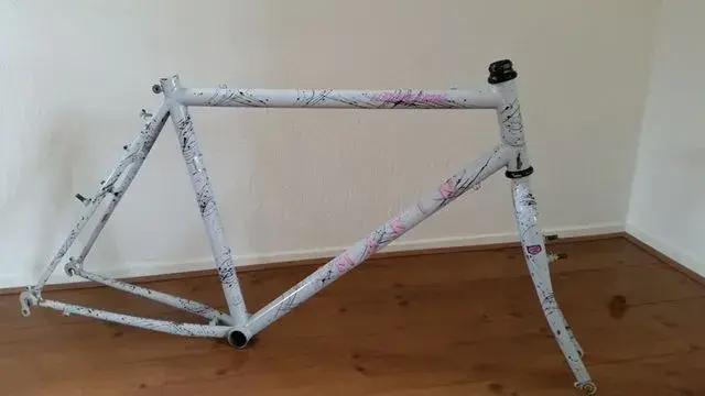

Another Marin decoding question. I did read the thread, but I couldn't find anything resembling my frame number.
Marin Eldridge Grade
Frame number: 903030357

Benandemu":3sqeve8t said:
That's because your frame is a continental 1989 model, and uses a different method of coding.
Thanks, are there much differences between the "normal" model and the contintal model besides the paintjob? This bike came with DX sti's, full LX and Wolber AT18 rims.
I had the same issue on one of the same year: Asia / US model in fluoro yellow / orange splatter, it had a number similar to yours. It was M550 LX and Wolber AT18s etc too.
