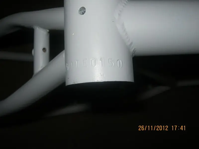

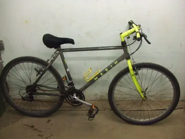

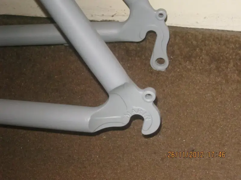

Help with Marin frame numbers please!
a before pic of the marin and after pics of the frame and numbers the numbers are A50IE0150

Definitely a 1991 Palisades paintwork! However I thought the cast dropouts didn't come in until a year later.
Certainly some around the end of the year got mismatch between frame number and decals. Yours looks like a Bear Valley number - which shared the same frame anyway.
So I suspect yours is an early 1992 BV (perhaps prototype) painted up in the factory as a 1991 Palisades.
Sorry, just gone to the garage and checked my 1991 Palisades frame. It has got the cast dropouts.
So you have a late 1990 manufactured frame in the 1991 colours - it was probably one of the first stock of the year. The frame is stamped with the BV number, but as it was the same tubing etc etc.
