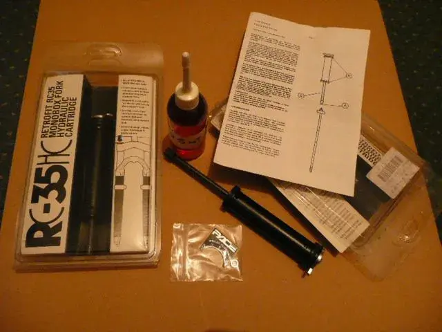

Although they have MXCD transfers[or remnants of!] they dont appear to have the oil damper fitted, i know the damper was available as a retro fit kit[see photo] but i am not sure on the factory fitment details, i.e if it was offered as a choice at time of sale. I have serviced quite a few MXCD's without the damper.

Oops; here is photo of optional damper; one displayed, one in packet. Note the retail price-£49.99 :shock: Also note only 2 1/2 wt oil.
