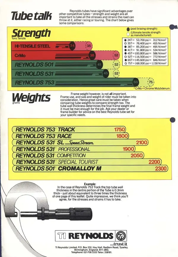

I am guessing but I think the serial number B710XXXX denotes a 1987 bike made in October. Mine is a Perthus Pro. It also still has the barcode sticker on the chainstay saying Which denotes type and paint finish I guess.
It would a big con if the forks and stays weren't 753, certainly my forks are labelled as such. When I get a mo will get some photos sorted if that would help.
531 P and 753 were different weights. Here is the Reynolds brochure from mid 1980s that sets out their range for framesets.
Can't account for the lack of chain peg but everything else suggests 753, especially the weight. I read the views about chrome and 753 but Peugeot put chrome on 531 P and on 653 as well, so not sure I share that view as a general explanation. Ride feel was a big factor with 753, ie stiff, reflexive, and could feel the road BUT some said too harsh (famously, Merckx, who put his name on many bikes after his racing career ended, ie one of the stories behind 653 tubesets). I happen to have Peugeot 531P, 653 and 753. The 753 is the harshest of the 3 but I love it's tautness and the sense of speed it imparts. One of my sons happened to borrow the 753 this w/e and sent a text to comment on how quick it was. 531P is the softer ride of the three, the 653 feels steady on long rides - look how many people toured using 653 framesets.

To cut to the chase, I'm with Danson - if it looks like 753, sounds like 753 (the ring makes a lovely sound) and it weighs like 753, can't think it would be anything else.
