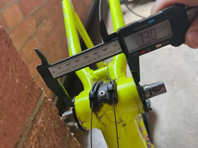

Thanks so much @gtturbo for reply and help, ahh ok that makes this sound way more simple, don't worry about trying to get yours out to measure 🙌🏻 just checked mine and its a 73mm. Ok i'm going to start the search for a UN72 or 91 in 73mm 1.22mm if i can find one. Thanks so much again.

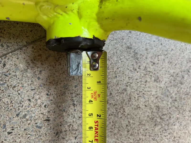

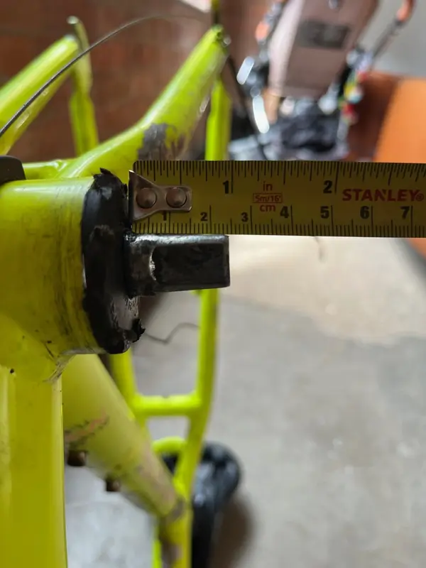

Sorry for delay, family came home 😩 spindle length total is 126.5 & drive side protrudes roughly 2.5cm & none drive side roughly is 2cm, not sure how well this worked as the bike was un-rideable so i stripped it straight away. Ps thanks for catalogue i did check it, but it just says sealed mechanism for BB.
