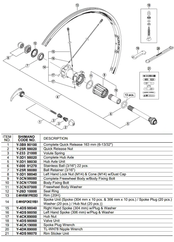

I think you're talking about the parts marked 11 & possibly 12 on the diagram below? Without seeing what you mean, I can only guess. Hopefully this will help though...

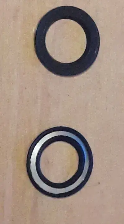

yeah, one seal is #12 and the other is not shown as it's inside the freewheel body. They are different !

Cant quite tell from the photo, but I'm assuming the top one is slightly thicker with a smaller diameter lip on one side? That's your NDS seal or number 12 on the diagram.
Now that I know where the other seal came from its easier...
The other one is for the outer side of the freehum body. The brass ring helps it sit securely in the body. It is indeed not shown on the diagram. It should pop back in relatively easily, but be careful to not try to force it if it doesn't go in first time.
