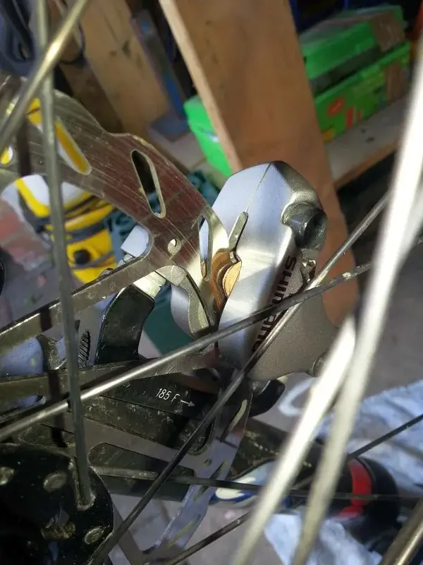

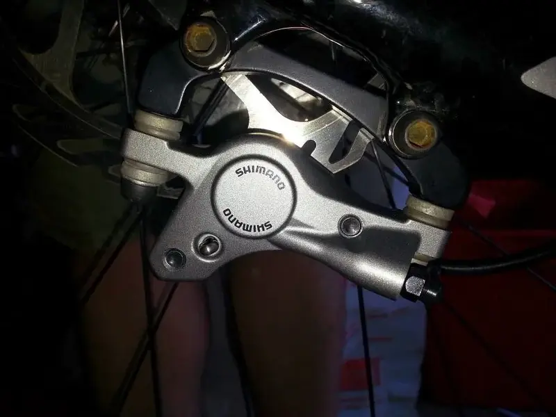

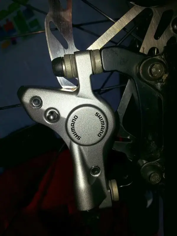

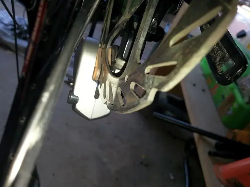

I bought some Shimano calipers and levers, good value at £75ish I thought.
Anyway I've gone to put them on my Stumpy FSR (which used to have Avid Juicys on) and the pads don't seem to line up with the discs. The pads sit about 5-10mm outboard of where they should sit relative to the disc surface.
What do I need to correct this - new mounting adaptors, new discs? Can someone tell me the bits I need to buy to get them to line up?
The discs are still the original Avid items - 185mm at the front and 160mm at the rear. I was hoping I could use them again as there's nothing wrong with them really.
What's the cheapest way to fix!

Take those spacers out between the caliper and the post mount adapter. That will drop the pads further down the rotor. Is that what you mean?
I forgot to mention that... they're not spacers, they're spherical washers that allow the caliper to be aligned to the disc. I'd rather not lose them unless they're not required...
They aren't required. You only need the side to side movement of the actual caliper against the post mount adapter. Avid use those things to fiddle about with the angles and stuff but on a normal caliper they just aren't required. I run Hopes and the caliper goes straight on the adapter, no fannying around. I have a set of Avids on another bike that have those but I have used Hayes, Hope and fettled some Shimanos and never had to use the spherical washers.
Bert - thanks, that's exactly the advice I was looking for. I'll give it a go without the spacers next. I might even get the grinder out if they still don't fit...
