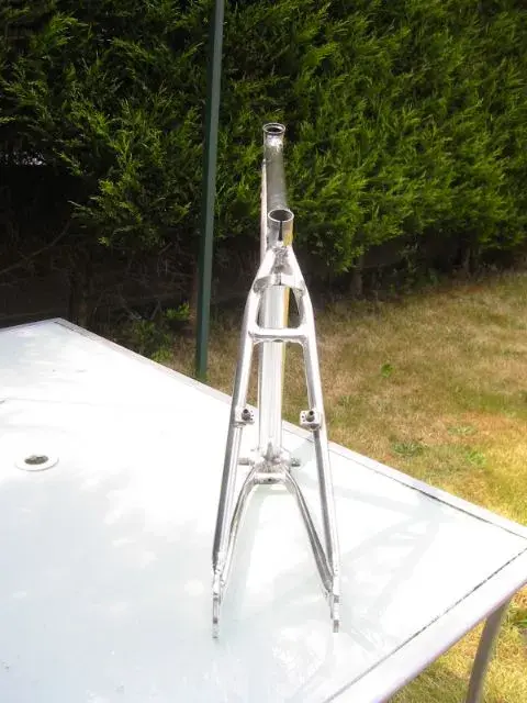

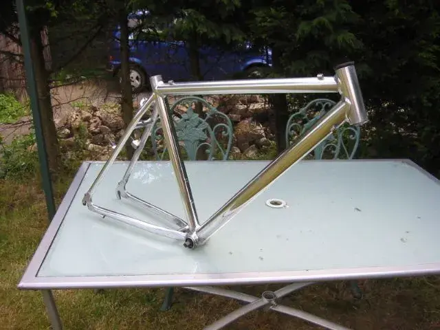

Help needed identifying my recently acquired Marin frame
And just to prove it, while I had 5 mins.....
finally got my pics small enough to attach, still more polishing to do though.

I was looking at a full retro build hence trying to correctly identify the frameset and then to get the original specifications for the bike ( assuming after polishing I dont get itchy to build and ride lol).
Finally found my sliding calipers !!! The frame downtube has a diameter of 44mm and when tapping along its length it sounds almost tunefull in the middle whereas at each end it changes to a quite dull sound, this is also the case with all the other tubes.
Assuming that means double butted (the sound*) it's a Rocky Ridge.
Which would put the other members form the code as a Rocky Ridge as well.
(* as it would normally sound duller at the ends as there is less distance to the end fixed end, but I think from your description is the Double Butted sound).
That's the best I can do for you.
Thanks heaps for all your help Fluffy Chicken, now I finally have something to aim at Although I feel this frame will be built up in a number of different ways as I search for original spec parts.
