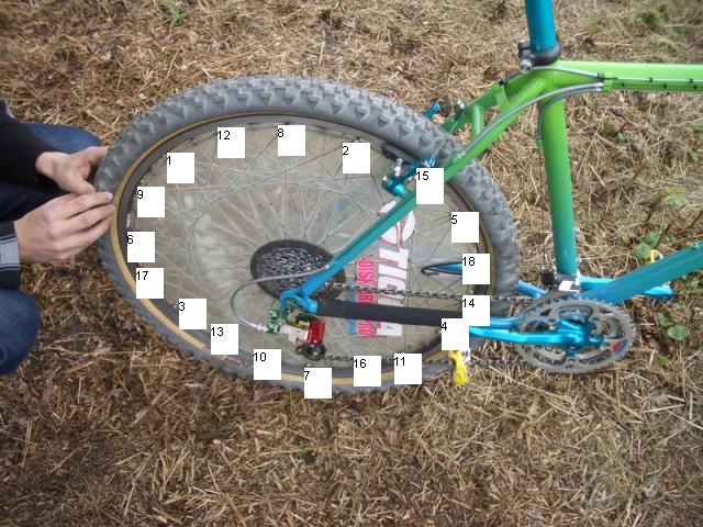

I got a disk drive manual but its for a 32 spoke wheel and not 36 hole. Now i assume the truing pattern will be different but the one pictured here:
Is totally different to the one in the 32 hole manual. Is this correct or can anyone else shed any info. I also assume that you still do the none driveside first but would follow the same pattern as the one above and not reverse it?
