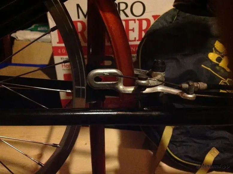

Here is a picture of a Weinmann 730 in situ. It isn't the original brake which is slightly longer and of a chromed steel nature. I have put this in so people can advise as to which size I need.
Many thanks.

47p2":6mp6dle4 said:
Are the wheels the correct size for the frame?
I think so although the only history I have is from when I saw it thrown away and ready for the scrap metal men.
It is a new rim. I replaced a 16 3/8 rim with one the same size. The new spokes came to within 1mm of the old ones. Also, going by the mudguards, it is the right size.
Do we think an 810?
