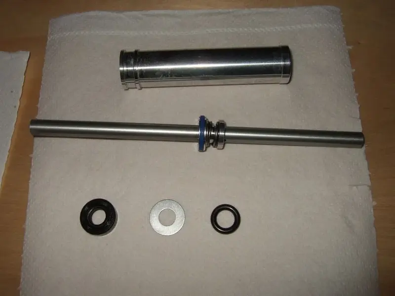

Right, cleaned the damper unit out completely and it's basically in mint condition still. I've managed to refill it and get it all back together without any problems.
I've removed all of the Wings kit from the forks, cleaned everything out including the dummy leg from the other side of the fork. Re-greased everything and put the original damper unit and the old Speed Springs back in and closed it all up.
Result is perfect working fork again :) It's still occasionally bottoming out but not as much as it used to so I think the cartridge rebuild has helped quite a lot. I'm going to keep my eyes out for a different set of hard weight springs which I think will sort it out completely but for now I'm more than happy.

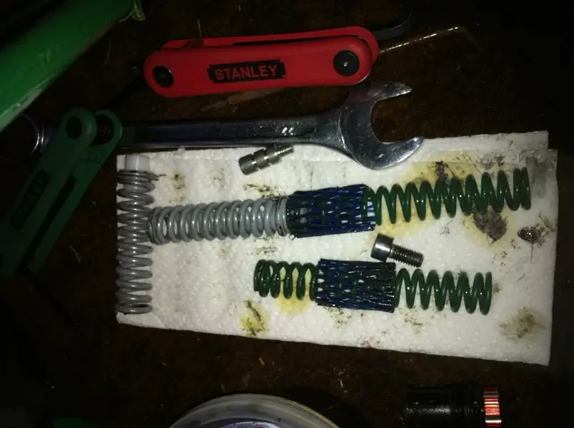

The wings ones are a two piece spring with a spacer in the middle, lower half green and the top half grey. These were bought as extra hard ones.
The set which came with the damper unit which were meant to be hard setting were lower half red and top grey.

Though I will pick up on this, the dual spring sets are the Manitou springs.
Wings springs are a single spring for the Judy. Not sure if Mr_Wings are the same as the old one's but according to his site it still is a single spring for a leg ? Even the damper unit one
Yellow for damper and red for none damper side (on the damper kit) is what the website says for over 220lb
Very interesting indeed. So it seems as if I've actually been sent the wrong parts on both orders, firstly on the hard spring set and then the damper kit.
Have attached a pic of the hard wings springs I received first.
The Speed Springs are coated red.

I wouldn't be surprised if the springs are the same as 'Speed' according to their info used the same SpeedSprings for Manitou and Rockshox of this era The 7" long ones
Here is Wings website, but not the video, probably the same one you mentioned above and I'm sure MY Wings springs (whoever bought them when) are a silver one and 6" long and use the white spacer. Though not a damper kit, just the springs

I assume Red for "Speed" springs is Medium, I had the Yellow which seemed harder but they're in a friends fork now. Their website didn't mention the colours, just the ratings and which forks what used.
