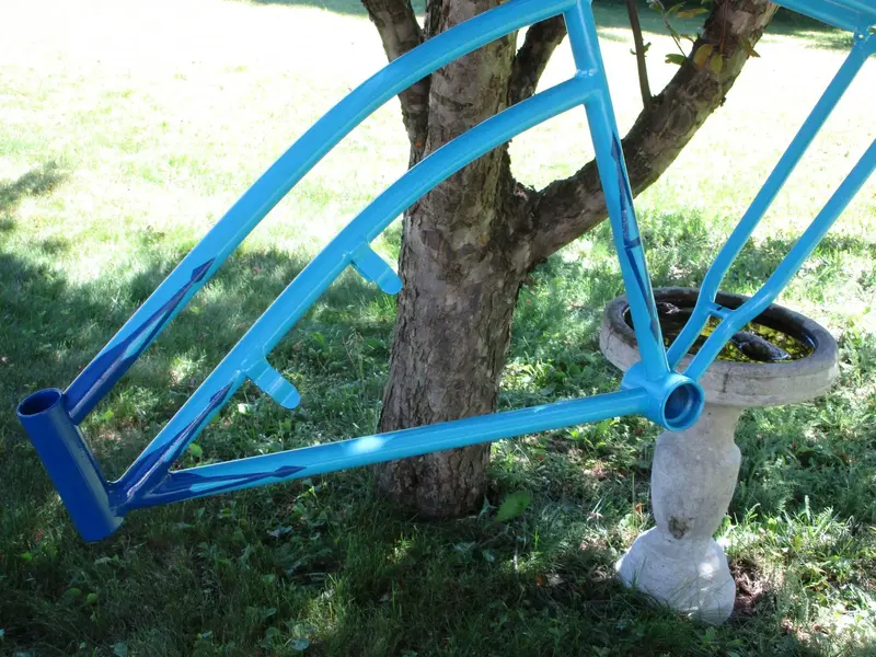

I’ve had two old 1930s steel frames that I got cheap because the top of the seat tube was snapped off because the post wasn’t in far enough. One was garbage, the other I fixed and ride. Better to be safe than sorry. You can see the weld just at the top of the brazing. You can get in there good with wire welding. Aluminum is garbage if this breaks.View attachment 910659
