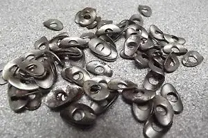

I have just take my front wheel apart, cutting out all the spokes , bar 3 or 4 which I removed intact.
Strangely, there were two different spoke diameters in the wheel, 1.5mm and 1.8/1.9ish, with the slimmer ones appearing newer and less tarnished. A bit of internet research indicates that my rims are almost certainly Conloy Constrictor, #4 standard. Weight 18oz.
The Constrictor catalague of 1938 shows the nipples as being special no 4, with fibre washer ( see earlier post re. fibre washers)
My wheel had no fibre washers and the reason I could not turn the nipples to loosen the spokes, was that the brass nipples were semi seized in the alloy rims!
What was special about these nipples and is anyone lokely to have any in stock?
If no stock, which seems a strong possibility, what have other Constrictor rim owners done, when rebuilding wheels?
Colin
Hi Colin, Mick at Madgetts Cycles has brass washers. Rims are Alloy and helps any problems with load and different metals can react with one another. Its likely spokes have been replaced in their time and with anything available. Remove the sprocket/cassette on the rear before taking it apart. Easier to do so with wheel built.
Simon
These are what is recommended and some on ebay.
