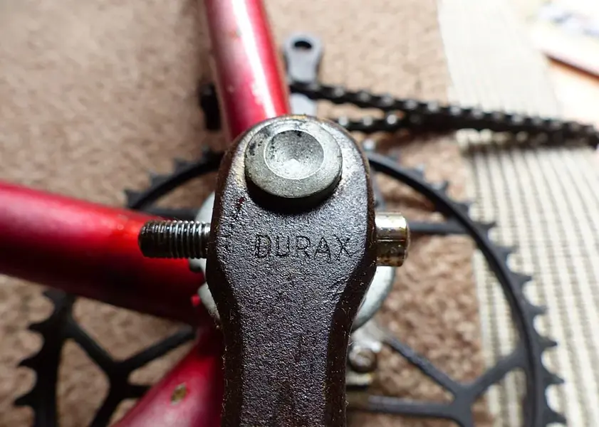

On a slightly different tack, I have now removed cotter pins, chainring and crank.
Acting on the good advice of WD-40, yet more WD-40 and time, certainly helped.
The chainset is marked Durax on both cranks and the chainring is quite a slim, elegant affair.
Is this likely to have been original equipment?

Just saw the Durax cranks. Look like British size, but many had French pedal threads. If loose on the axle this is likely, good quality cranks, always with poor chrome, but if you plan to refinish check the pedal threads first.
Keith

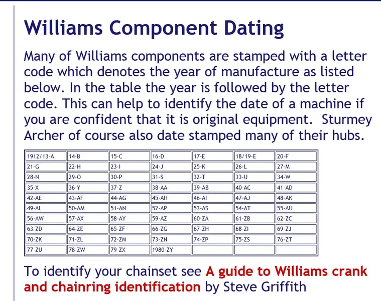

Is it likely that the date number might be near the centre, under the two mating parts?

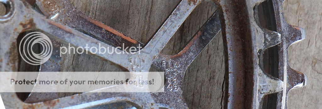

two Williams rings showing the location of the stampings:
Williams logo
year code
number of teeth
I don't think they are forged, look like they're pressed out. I've seen them bent back but not sure they need heat or can be done cold and not as much as yours. Hopefully they can be repaired ok. Just don't understand why someone would bend them out in the first place?
Simon
