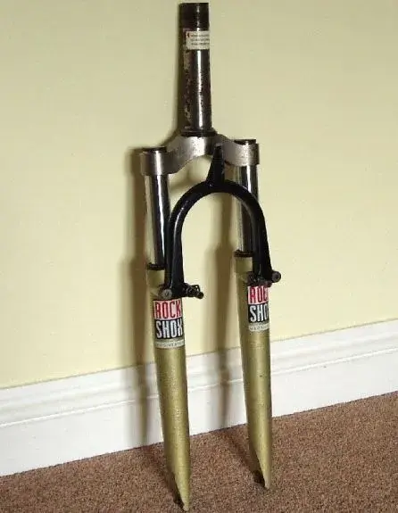

I’ve recovered some old RockShox lower legs from the back of the shed
They are from the Mag series but I’m not 100% sure which model exactly
Can anyone help?
They are gold lower legs, with a black fork brace and the air caps have numbered dials between 1 and 6
The decal says RockShox magnesium, serial number is #75849
If there’s a Rock Shox “Magnesium” sticker then they’re Mag20
Mag 21 had a stylized M sticker on the bottom of legs with 21 underneath
pictured above are MAG30 ,if they look like that, with dials they are MAG20, note the stepped section where the brakes and brace mount.
if they don't quit look like that and look like the picture below they will be MAG21 1993.
there are later 94/5/6+ mags but the dials are different.

you gave the serial number, if it's a MAG20 1992 lower leg. The numbers in the middle of the batch recalled (it was just the crown at fault not the legs)
