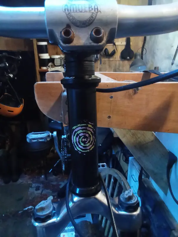

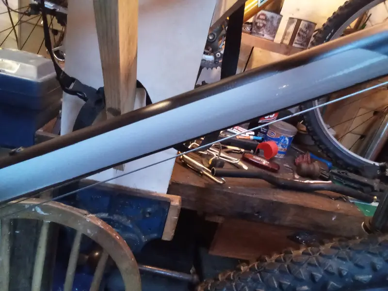

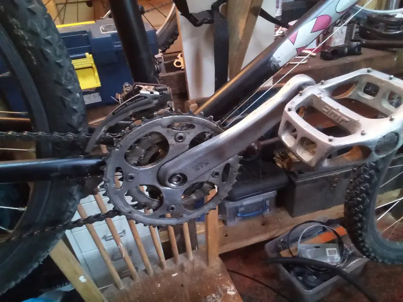

I've revealed the steering tube decal, it's a pink and yellow jagged swirl. The original colour is a pale gloss grey. The brazeons on the rear seat stays are not welded to the stays like the 1992 ones but are flush mount like the 93/94 era. Any ideas?

The spiral headtube logo would mean '93 to '96. The grey doesn't match any bikes that I am aware of, the only grey's I can think of were more metallic. So maybe that isn't the original colour either. You could check the inside headtube or BB shell to see if there is any over-spray. The seatpost does look like a Kona O-Beam which, if original to the bike, would date it to '94 as I think that was the only year they used that. Impossible to tell if any of the other parts are original, a real mix though.
If it is a '94 then it could be anything from a Cinder Cone down (the higher frames would have a seat tube bulge at the BB). Only the S/N would give the true answer on the year, then weighing the bare frame might help with working out roughly which model it is. Cinder Cone/Lava Dome were the same double-butted Tange frame, and the Fire Mountain/Hahanna were plain gauge Tange.
