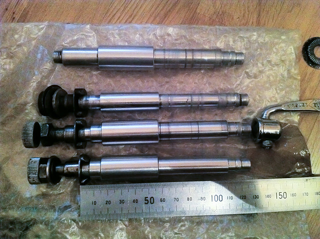

The wee special end nut for the XL skewer is still available from Hope for about a fiver :wink: They still do the skewer as its usually for tandems[£18 iif i remember correctly]
The spacer is hard to find though,i got one off Ricks bikehut place and just about tore his hand off :lol: :lol: That said mine is a tight fit for the bulb i want to put it on but tbh i can see that you couldrun it without :?

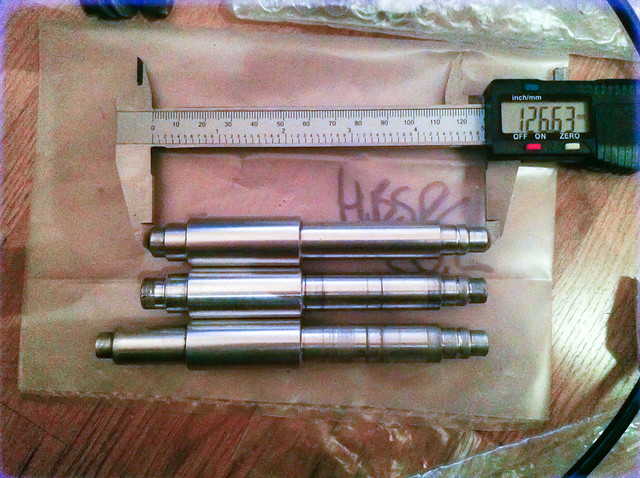

Axle-Easily cut down,they do or rather did do a short version but i gather most just hacksawed a bit off the end

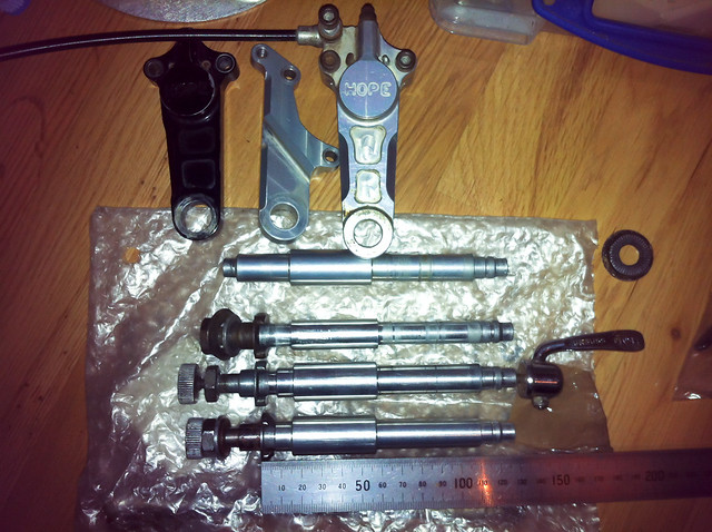

IIRC I have the rectangular Lobo torque arm in my Hope Spares Box. The adjustable heim joint one in the pic is off a Straight 8 and the tapered clamp is off a LTS.

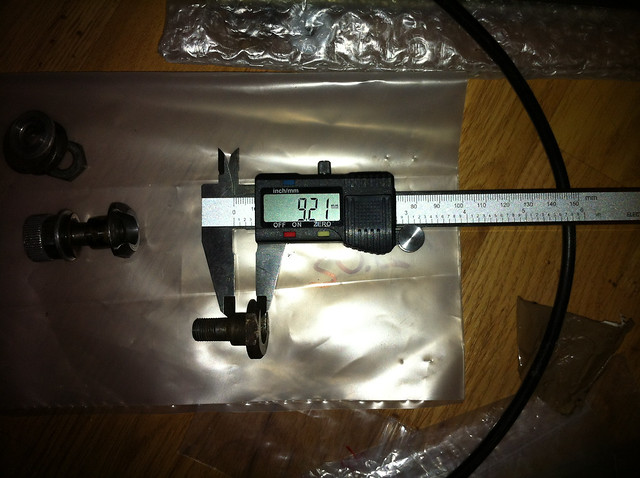

This is super geek and boring but I found posts like this handy while trying to figure stuff out, it beats looking at 100's google images :o
Bottom is GT Lobo original, the next two are Big Un and Bulb for Hope normal hub mount caliper and long one is original Big Un no caliper. :D
Sorry about picture quality :roll:
Lobo one in calipers..
Lobo caliper, LTS? Mount for IS, Hope normal hub mount.
Hope normal frame bolt
Lobo frame bolt
How it all fits
